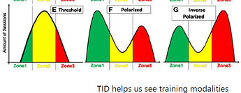

I’m no expert, but this stuck out to me from study cited…
"Scientific evidence supports that a higher percentage of training time (from 70% to 90%) in zone 1 has a high impact on performance (Esteve-Lanao et al., 2007; Muñoz et al., 2014a; Tnønessen et al., 2014). An excess of high intensity training can lead the athlete to overtraining or a higher incidence of injuries (Maffetone and Laursen, 2016).
Based on this previous research, it seems clear that high part of the training time should be in zone 1, but several questions arise such as, “how should the remaining of the training be distributed?” or “what is the best training intensity distribution model for recreational athletes?” There is no definite answer to these questions to date."
My issue with TR plans above LV, and the question I’m far more interested in hearing TR address on Thursday, is the lack of zone 1 (Zone 1/2 in a 5-zone model) when athletes move beyond 3-4 1/2 hours of weekly training. I’m also less interested in the debate between POL and PYR or the value of SS.
Even in TR’s blog post about the necessity of low effort endurance training Zone 2 Training for Cyclists: Where Endurance Training Fits in Your Training Plan - TrainerRoad Blog, they make the argument that SS trains the same systems faster. To me, that’s where TR goes from science to selling Kool-Aid. (And I’m a loyal fan of TR and their customer support, other than this high-intensity over endurance bias, their missing Master’s plans and hopefully soon-to-come group workout on iOS.)

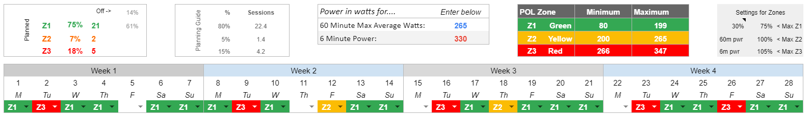

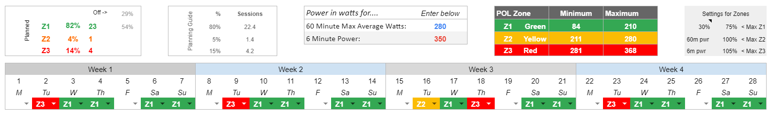

During end of 2020 I was on paternity leave hence couldn´t do much volume on weekdays, it was either above FTP work or SST. Wanting to improve my TTE, and knowing I wouldn´t be racing for several months, I did 3xSST per week from Sep to Dec. Adding endurance rides on weekends and “in-between-days”. So sort of a “poor mans POL”, i.e. 80%/20%/0%… This worked really well for me since the lack of really intense stuff meant that I was well recovered for the long SST workouts (progressing from 60min up to 100min TiZ). After final SST block I performed an lactate test, LT1/AeT up by 40W to a new all time high.
December I did a 4w build block: 3xZ3 sessions per week + Z1. I was surprised by how well I managed these workouts considering having done 0min Z3 for over 3 months. However, one mistake I did was to do 4w instead of 3w (aligned well with the holidays…). Was really tired during the fourth week and had to dial down the power on the last Z3 sessions. Took one week completely of the bike. Had to recover.
(Luckily this was in early Jan and not end of May…)
Plan was to continue 2021 with a PYR approach but as I started working again, meaning commuting by bike everyday, I noticed I didn´t recover enough for my “hard days”. Even the once a week SST felt hard. Had to change something.
So I completely skipped the SST. Left was only 2xZ3 and Z1 (plus some strength training). And I do the Z1-commute-rides really easy. Even if it´s only been 4-5 weeks of this modified training plan I feel so much better on the bike. Not only during the Z3 sessions, but also on the long Z1 weekend rides. Will definitely continue a POL approach throughout my base period. As for my build period I had already planned it to resemble a POL approach (gonna do block periodization).
