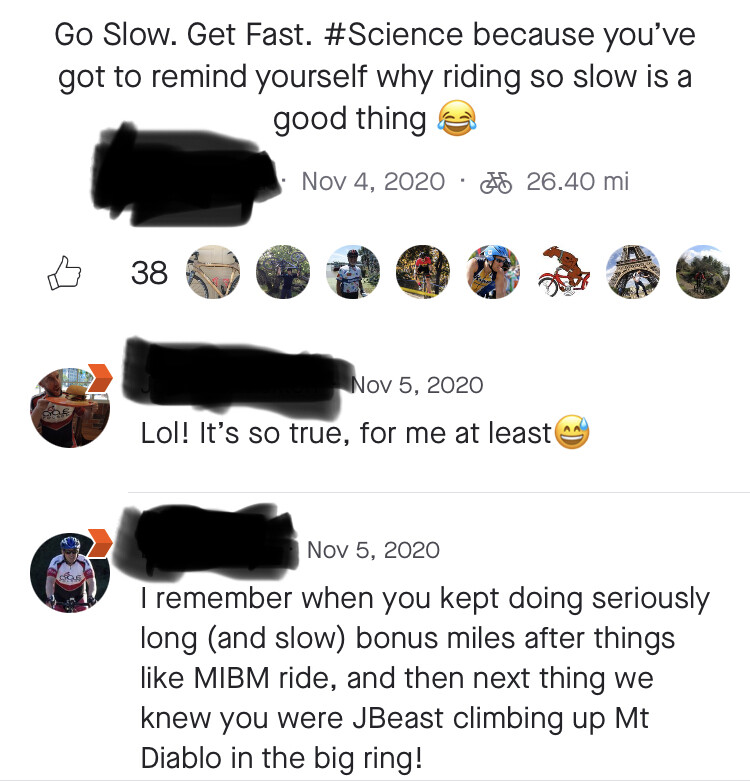

if you struggle with recovery then polarized may in fact work better… even at 6 hours a week. Back before the road bike I got a nice FTP just doing spin class HIIT twice a week for 75 minutes each session, plus an outside ride or two. The key was smashing it for 20-30 minutes in spin class. My muscular endurance was crap, but good enough for 20-40 mile group rides.
Discipline is a whole 'nother topic, and conflating group rides with zone discipline is a bit of a red herring. Either don’t do low-intensity rides on group rides, or like a local cat2 hang off the back and tell everyone your coach said nothing higher than 150W (or whatever low-intensity is for you).
Bottom line, you are in charge and can do anything you set the mind to do.
I didn’t know you were Cat2 :stuck_out_tongue_closed_eyes:
LOL not me! I just happen to ride with a bunch of 20-60+ year old bad asses.

your name is showing lol the cloak of secrecy has been broken
Stalker! :rofl:
