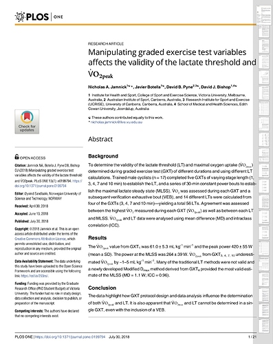

This journal article would Suggest that even the best scientists out there can have issues with “validity”.
Confirmational bias is a real concern when looking at any of the work in this area and leads to an even greater need to look at the zones as ranges instead of one particular number and that it shouldn’t be dogma that if you fall out of the zone then the effectiveness of the workout for a given goal has been compromised. Even LT1, LT2 and VO2 max data can be out a few percentages which in dogmatic world could change the stimulus/response.

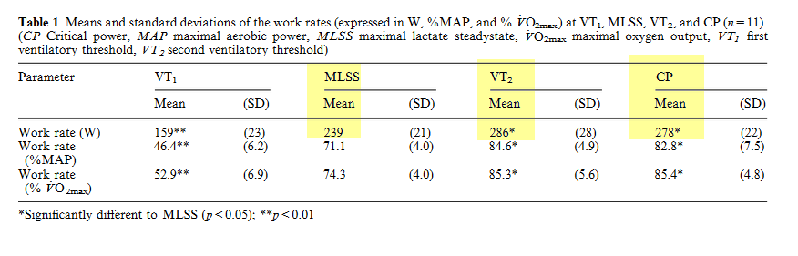

So many caveats with the polarized model. What is it actually?
grafik
MLSS == LT2 == VT2 ?
Dekerle et al (2003)
Furthermore, I would like to question the assumption that “hard” or “Zone 3” is Vo2max work. The upper threshold from lactate and other lab tests is often much lower than assumed by our 5 or 7 zone model. Furthermore, add those annecdotes from Seiler that elites do this 6x10 intervals. Or his own research that shows 5 or 6 times 8minutes with 2 min rest is superior to shorter intervals.
These are all threshold intervals. Perhaps at the upper end of the range. Actually, SST would still fall into zone 3 when we’re actually realistic about the uppper theshold.
Why is this important? Many people believe that have to go dark, dark, dark red in the polarized model. I believe only a few people are actually mentally capable of hurting themselves so much. Others will fail to hit the targets in order to have a benefit (e.g. accumulate enough total time per workout and training block in the high zone).
