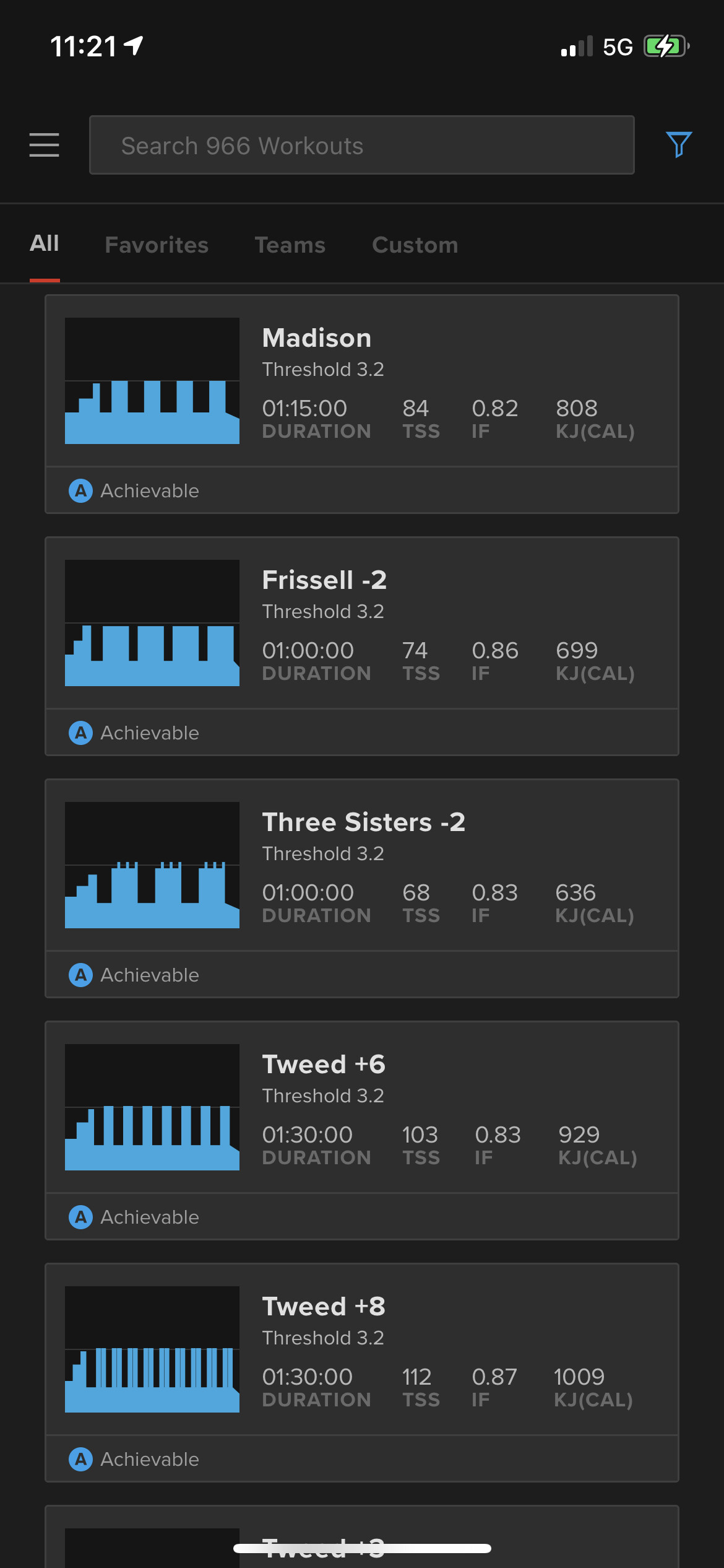

By comparison, here are the 3.2’s in other zones and they are not easy at all.
