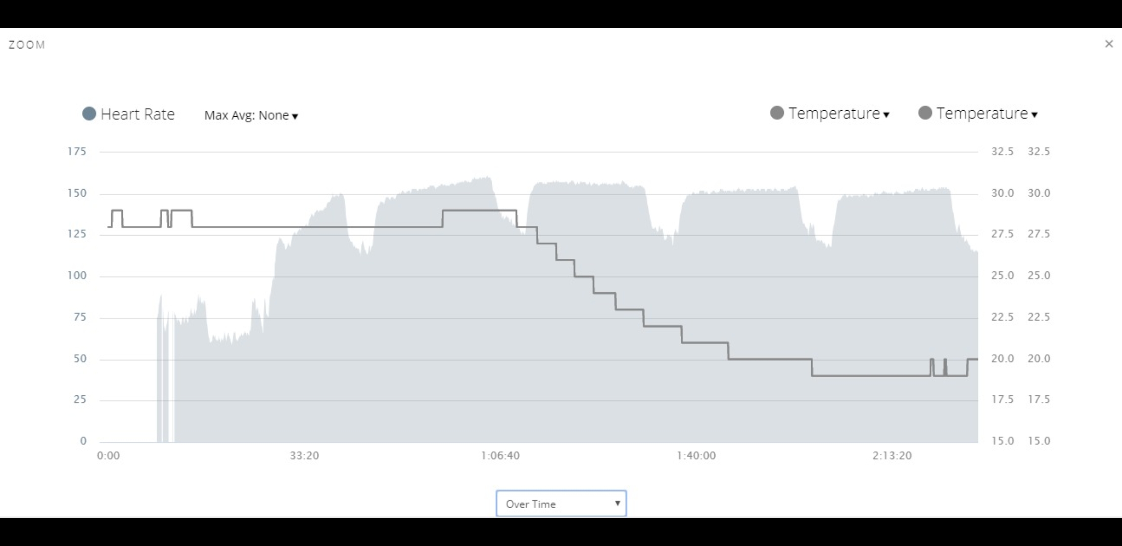

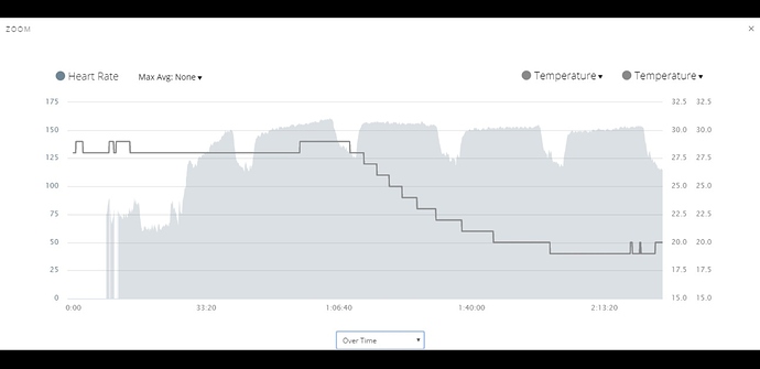

In the interests of science I conducted a quick experiment today with Galena +3 (4*20mins SS @ 90%).
I started the session with no AC, only fan and my Garmin had the temperature around 28°C. My other thermometer had it around 30.5°C.
I did the warm up and 1st 20min interval without AC and the temperature naturally got higher. My HR for this SS interval was more in line with what I’d expect for a TH interval.
After this 1st interval, I kicked the AC on, so the room temperature dropped. Interval 2 my HR descended the whole time. Intervals 3 & 4, when the room was cooled down, my HR was probably more in line with what I’d expect to see for a 20min SS interval. Albeit a shade higher.
Without doubt, the room temperature had a significant impact on my HR, my RPE and also the amount of sweat on the floor
