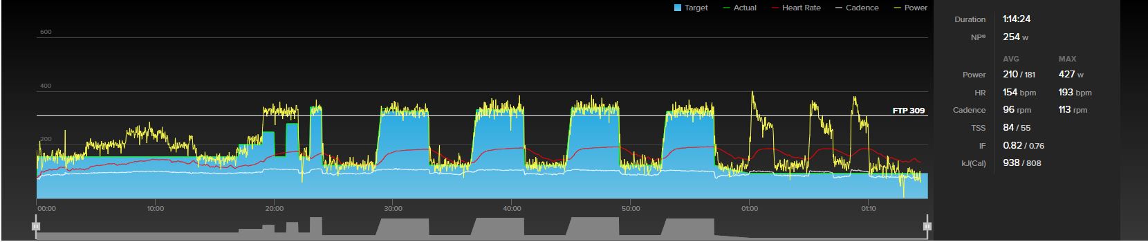

I’ve included screen captures of 3 workouts. Two of which were indoors, one of which was outdoors.
One indoor workout I did based on HR and basically got my HR to 185BPM which is about 95% of HR max and held it there decreasing the power.
A second indoor workout was done this week where I adjusted the power on the first two intervals to be a bit higher at the beginning but was still less power than my outdoor workout. The HR reached 192bpm where it basically sat there for several minutes in the workout. This is 98% of max HR. Yes it was hard, my legs hurt, I was breathing heavily but I was NOT about to die despite my HR being super high.
The outdoor workout is 4x5min with a couple of add’l shorter intervals at the end as the road allowed. Power was generally higher than the indoor workout, HR more controlled, but breathing harder at the end of the 4th interval. Legs were pretty tired at the end of the workout.
So this brings up a few questions. When I’m doing these indoors should be focused on power or HR? Some data suggest that HR above 96 or 97% of HR max for more than just a few seconds is COUNTER productive? In otherwords it pushes the heart and neuro systems too hard and blunts adaptation responses?
I am going to buy a proper fan at the end of this month for my indoor riding area, so I hope that helps with some of these HR drift that I have indoors, but I still need to know how to do a proper workout indoors to maximize adaptations.
Ignore HR, focus on power and breathing. Go hard and keep as long as you can. The first workout is plainly bad workout - if your power goes under ftp while doing vo2 max then cut the interval - no point doing it.

I’m trying to understand the first workout. Assuming FTP and HR Max are reasonably accurately known, was it performed in a sauna while having espresso delivered intravenously?
Not saying about zones but from pure vo2 max training. Have nothing against hard start and then holding power - done some of those. I was just saying about pure vo2 max workout where you want to hold high power and hold it above anaerobic threshold. If your power is falling down as much there youax doing hard start threshold/sst workout - completely different thing than vo2 max focused work.
FTP and HR max are in the ballpark for sure. Long inside sessions my HR drifts quite a lot higher. I suspect this is heat/dehydration. I have only a very small fan. The room heats up quite a lot also due to body heat during the workouts. Room might start at 72 degrees and at workout end could be 80 degrees on a 2hr workout. With no ventilation it’s just a sweat fest, hence the buying of a new fan at the end of the month.

To be clear the breathing at 98% of HR max, for example the one labled “indoor power”, is quite labored. There’s nothing easy about it. It was very hard, but also if I were outside my HR would probably have been 5-6bpm lower.
Indoor power is good vo2 max workout in my opinion. HR clamped not so much (as vo2max workout). If breathing is hard, hr high - good vo2 max. Ignore HR during the workout. And investing in the best possible coolong is always good investment.
Shorter intervals inside are no problem for the most part, especially if done in the first 90 mins or so of a workout. 1min and 2min intervals are more than doable without my HR going berzerk. I’m hopeful the new fan will help a lot, when it finally cools off that’ll help a bunch too, we keep it cool over night in the winter so it’ll be 63 degrees in the room which makes a noticeable difference in my HR.
@jarsson that’s the conclusion I came to as well. While I was hot, breathing hard and tired on HR Clamped I definitely wasn’t that tired and my breathing was more in line with sweet spot vs VO2.
