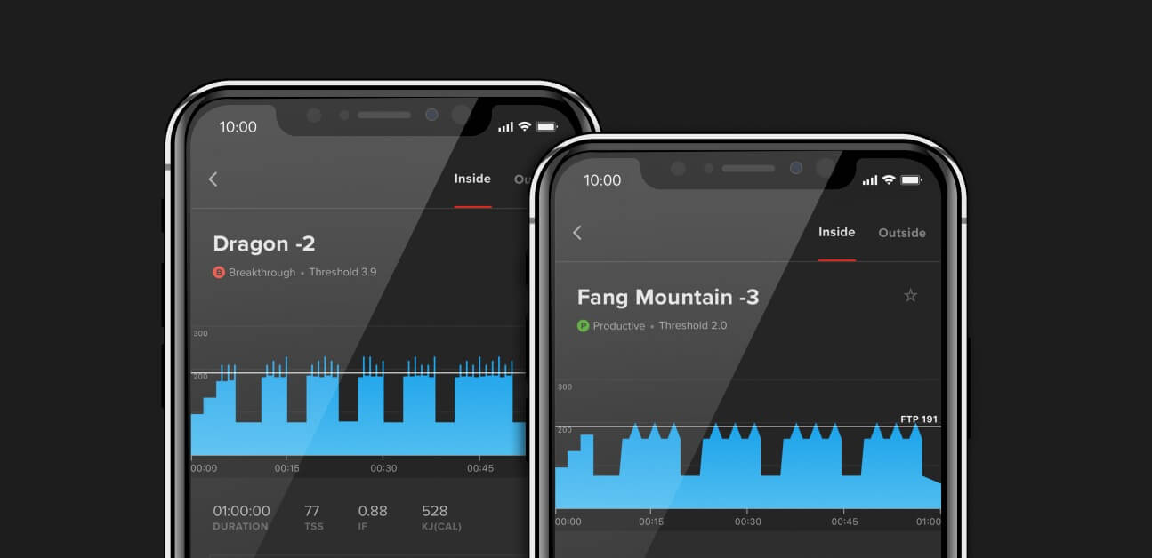

More TrainerRoad thoughts on over/unders in Meghan Kelley’s recent blog post:
Again, I think traditional over/unders are an ok workout but not the best way to improve lactate clearance. Especially among trained athletes the most adaptation to MCT4 in the membranes of the muscle occurs when the difference in lactate concentration across the membrane is maximized. We’re all producing lactate even as we walk around the house but that doesn’t lead to MCT4 up-regulation. But when we produce a LOT of lactate in the muscle while there isn’t much lactate outside the muscle then lactate transport really has to work hard, hard, hard to move that stuff out. That is what stimulates adaptation.
Once concentration on either side of the membrane gets to be about equal adaptive stimulus is less. I think Green’s work supports this notion. Athletes get some adaptation even in Z2 but athletes got a lot more adaptation by doing a few minutes of intense work…hanging out for an hour…doing another few minutes of intense work…hanging out…repeat…repeat. Intense work generates a lot of lactate in a short time so stimulus to transport is maximized. And those were untrained athletes. It’s reasonable to assume that as athletes attain a more trained state they would have to whack the transport mechanism harder and harder to achieve adaptation.
Just something to think about. Everybody should click on that article and give it a read.
