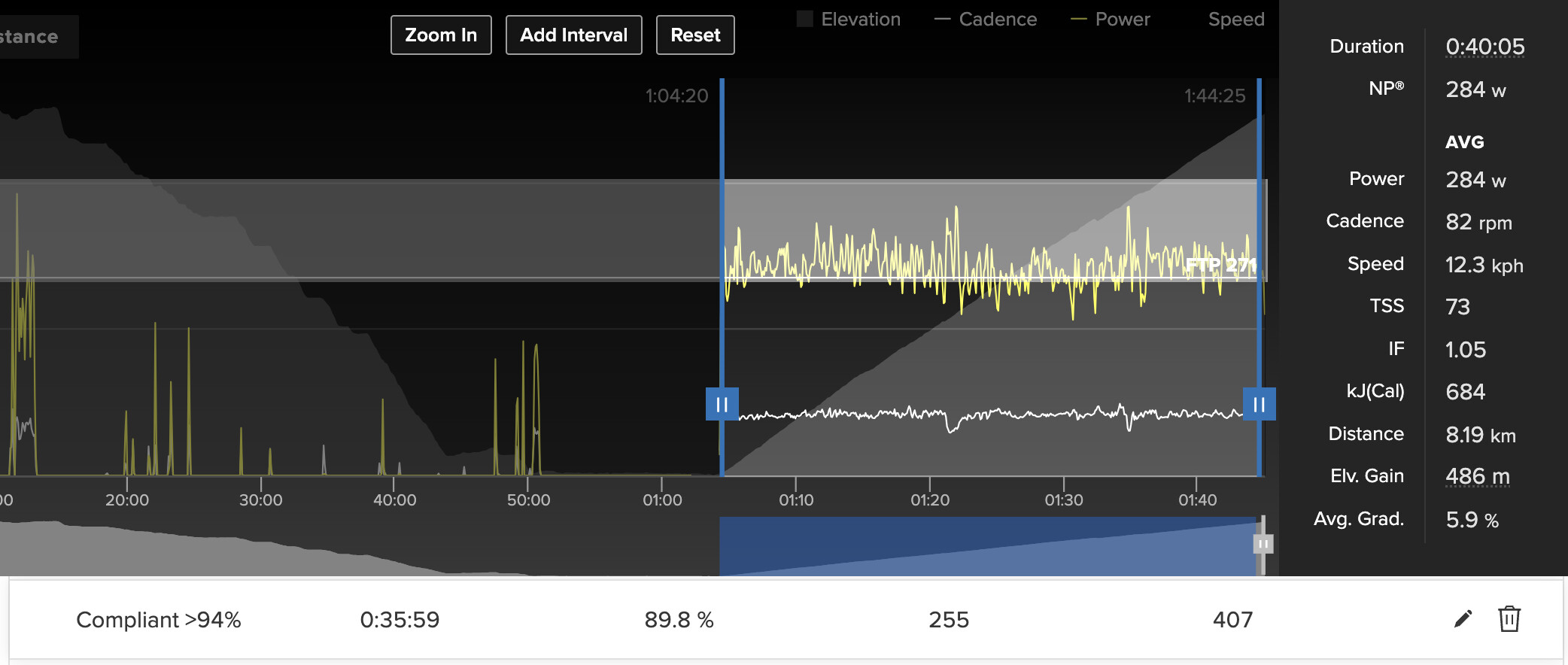

An example ride of mine: a 40 min TT up Falls Creek, I created a TR zone to see compliance. 89% of the interval was above 94% of FTP, so threshold or higher
36 mins of time in zone (threshold or higher)
So I matched this to a threshold workout with a 30 minute interval.

To answer your question, we don’t recommend matching an outside ride file unless you’ve actually followed the workout instructions, as this gives the system the wrong data, telling it you completed something you didn’t. :see_no_evil_monkey:
For the example you showed, I would not recommend matching your 30-minute effort to Lola -1 because you did not follow Lola -1. You may be working the same zones, but both efforts are inherently different.
This can also create an issue of getting a higher Progression Level credit than you’re ready for on your Threshold zone, and can translate to failing future scheduled TR Workouts.
All that said, there is also no need to match your 30-minute effort, as the system will take the effort into account and recommend any needed adjustments to your training.
