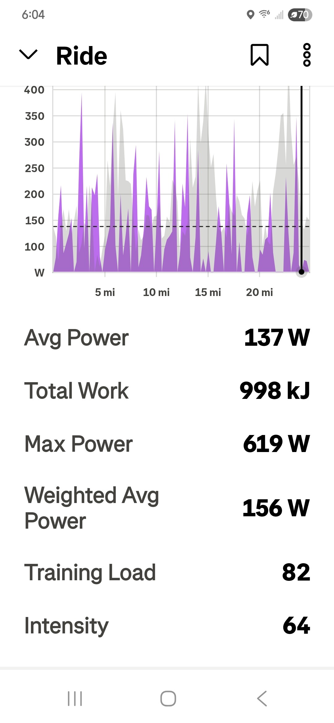

TSS gets the short end too. 400w and 0w average to a nice easy 200w right? RiGhT? :upside_down_face:
We always say NP for show AP for dough. As was said by the other person MTB and power averages either NP or AP can often be distorted. Try playing with different screen layouts on bike computer in terms of average. Have a look at this link for some ideas Garmin Screen Setup for Mountain Bike Training with Power - LW Coaching
Yeah I wouldn’t focus too much on power numbers for MTB races, unless there are long climbs; the efforts are so spiky it’s just a totally different ballgame. Also highlights how different the muscular and metabolic demands of MTB are to road!
