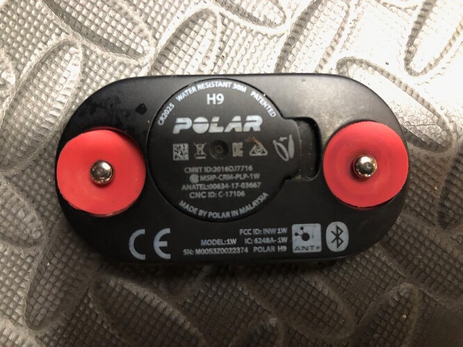

I used to go through HR monitors every 8 months (Tickrs, Polar H9s). Now I have it figured out. It’s not the sweat getting into the case. I ruled that out by application of silicone grease so that there was no chance of sweat getting in there via the battery cover. Yet the problems persisted.
The cause was sweat accumulation on the back of the unit that ultimately forms a connection between the two snap/poles. My solution is to make gaskets out of latex tube material that prevent the sweat from making a connection between the two snap/poles.
Cheap and effective:
Plus, you got to drink two beers to get them!
Bonus if you play guitar, they make great strap locks.
