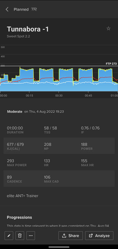

Well, 2nd workout done (Tunnabora -1) and 2nd lot of adaptions. Basically it increased my Tues/Thurs rides level up by about 0.3-0.6, highest week TSS in this phase is now 226 from 219. Today’s workout was a firm ‘moderate’, max HR in the low to mid 150’s, never felt out of my comfort zone.
AT seems to be doing its thing! :grin::+1:
