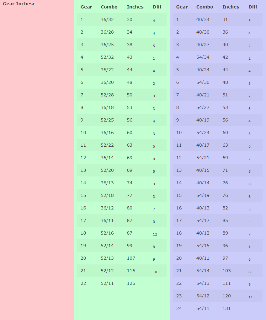

Really the 54/40 with the 11-34 cassette is killer. You get a shorter gear on the low end without giving up anything on the high end.
And compared to my current ‘climbing’ setup…
Same bottom end, with an extra gear in the ~100"+ range.
Then my crit setup…
Way more bottom end, and the jumps at the top end are still pretty good. The 85->96 jump instead of 87->93 is not the best. The 11-30 cassette solves that giving you an 85->90 jump, while giving you same bottom end and better top end.
