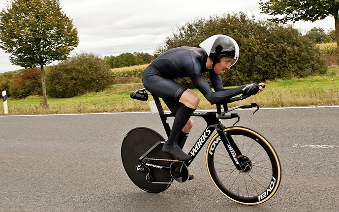

I just rode a Time Trial, that was ridiculously windy (21knots base wind with 32knots gusts - so around 40 and 60kph respectively). The course was super open, so not much protection from the wind. I usually ride 80mm front wheel, but went for my road wheel, the CLX rapide in the front instead. Staying in position makes a much greater difference, than 29mm of rim depth. It was a revelation. So stable, so easy to handle. I literally had NO sensation of steering moment. These wheels were already worth the purchase just for that.
And here they are in their natural habitat:
