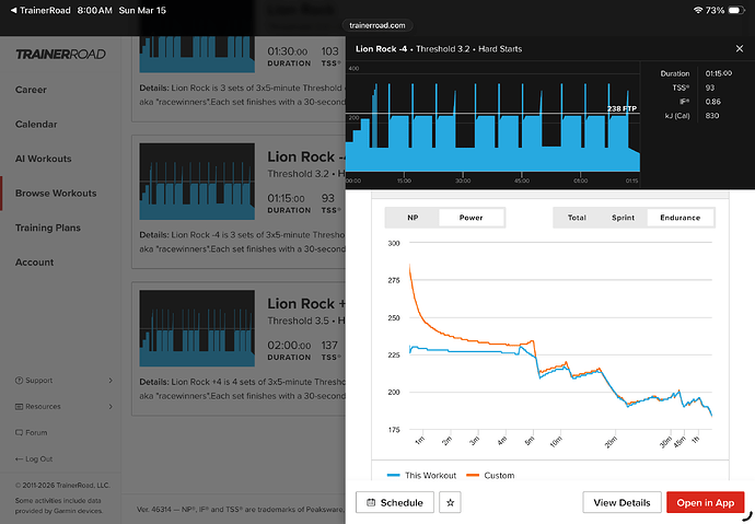

This is very helpful, I recently did Lion Rock -4 and remember thinking that the Power curve looked like it wasn’t showing the sprints in it’s graft.
Now I can see that it wasn’t
