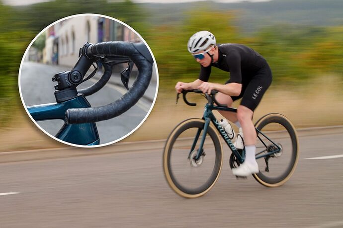

get on the turbo, and put a mirror in front of you, you will probably notice a reduction in frontal area on the hoods.
I read this just now and watched the short video. 40 watts saving from being less slammed. I wonder if it’s similar to what I’m experiencing.
this is just mimicking modern TT position on a road bike (“praying mantis TT position”)
with this fast position, you minimize the gap between your arms and your head/chest, specially with a ridiculous helmet like this, you end up with virtually no gap.
so yes, if you create something like this on your roadbike, you might be faster in a solo breakaway. but your will probably take out half the peloton if you crash :wink:
