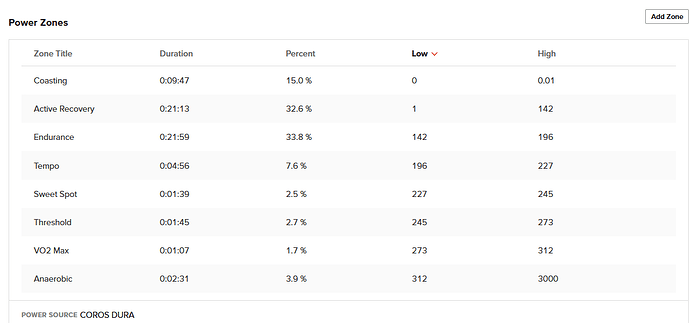

Curious question. Anyone experienced their workout showing that almost half of it was spent coasting in an outdoor workout?
I’m not sure if this is a TR problem, COROS DURA problem or Power Meter (PRO-MX1) Problem. Support contacted, but curious if anyone else has run into this before as well.

Yeah I’m not sure. I also downloaded the fitfile from coros and uploaded it to garmin. Garmin synced over to TR and now I see a coasting time of 25 minutes, or around 12% which doesn’t seem too out of whack.
Something from Strava → TR was funny that was adjusted again with a push from the same fit file in garmin.

I did test syncing another ride from coros → garmin → TR and it also alters the values. Sure seems like something thats being delivered from Strava is funky…
This case is a pretty marginal difference (15% to 14.6%) but it still indicates that something in the stream is producing different values.

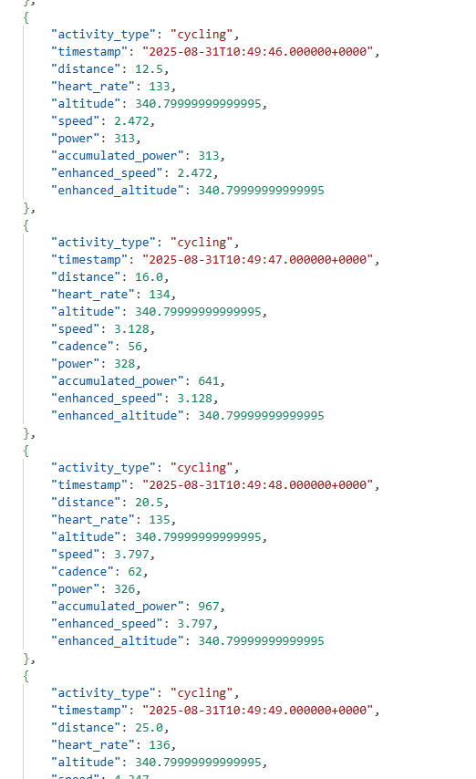

Doing a bit more of a dive here. I pulled my data from the Strava API and it looks like my data is being downsample to distance, creating gaps in the data with respect to time.
That said, it does raise a question in how the interpolation between data points is calculated for the TR side. If the distance is used, then only a subset of time points are returned and some form of interpolation must be happening in the intermediate steps to produce a per-second value.
Perhaps this is the origin of the odd coasting values in how TR then interpolates these gaps?
I don’t know why Strava is returning as a down sample values (storage/efficiency?) but this might explain why data sync’d from other platforms returns the proper data as, in the garmin case, they are able to request the actual fit file from the provider.
One other tidbit is the TCX file pulled from garmin shows per-second values. checking my raw fitfile from COROS is also is stored at a per-second value. (last photo).
Based on what i see here, it looks like a problem with how Strava is delivering the data. Whether that is a problem from provider → strava or a problem from Strava → TR, something is creating funky values.
