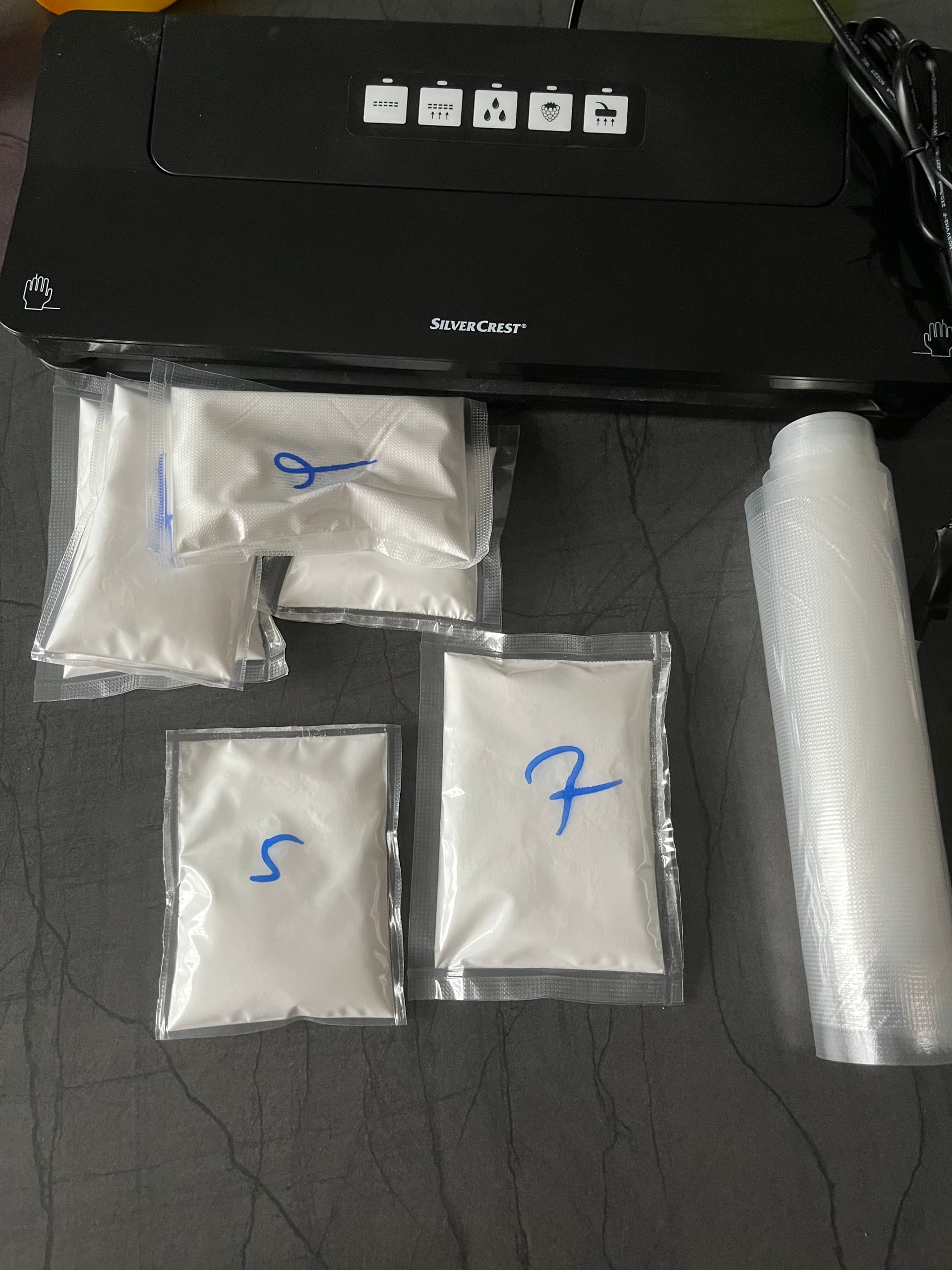

This is a great suggestion. On my last Century I started with a 4hr 100g/hr bottle, but switched to gels and food for the second half. On a recon ride I tried zip lock bags of powder that leaked/spilled and made a gross sticky mess of my backside for the rest of the ride. It would be great to do one bottle mixing stop and then just refill water along the way. Do you have bags that you can rip open, or do you bring a knief with you?
Any other suggestions for reusable sealable containers that people have had luck with for carrying mix?
Small ziplock sandwich bags. Reusable. Minimize waste.
And double bag. If I have a bag per bottle I will put those bags in another bag. I’ve found this method to work well enough in case a corner of the ziploc happens to open. I also make sure ALL of the air is squeezed out of each bag,
