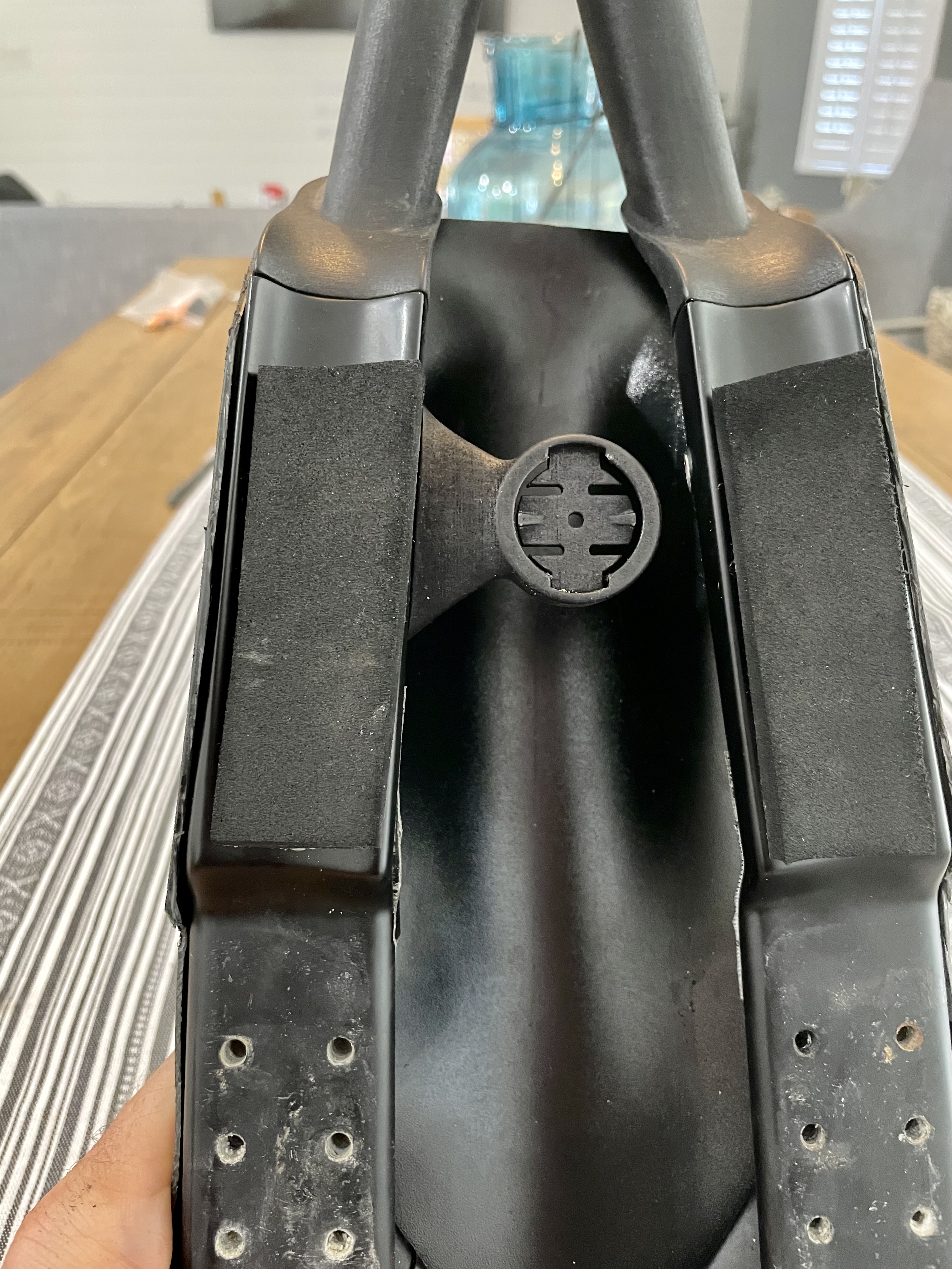

I’m taking a break from road/TT racing for awhile and just want to focus on doing rides I enjoy and not worrying about confirming to rules. I often do longer TT rides (100ish) miles and decided to fill in the void on my aero bars to hold things like food, phone, whatever. It might also be more aero considering it’s common on the IM pro setups albeit that’s not personally confirmed. Please don’t bash it too much, this was my first attempt!

What have you made this from?
Looks like a plastic or something.
It seems to have some thickness to it, unlike carbon or fibreglass.
I have been considering doing the same.
As you say, the mono bar’s are being used on most of the fast bikes in Tri.
Eyeball aero makes a lot of sense. Try guide the air around the shoulders

From the structure it looks a lot like Kydex to me. Its a easy to use thermoplastic
I made it from a 12x12 .08 thick sheet of Kydex. I put it in the oven and formed it on the bars. It’s strong enough to support a few small items. At the moment it’s only connected using Velcro but I need to add something else because I’m afraid of it falling when I’m 50+ miles from home.
