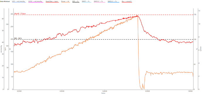

Just adding some data to the thread.
Today’s ramp with power and heart rate…like a cheese pizza. Can anyone tell me where a threshold is on this ramp?
Same ramp with some extra toppings.
The breath data from the ramp. I use VE as an indicator for breath thresholds.
I was being facetious asking about identifying thresholds from power-only analysis :slight_smile:
This was a ramp starting a 1w/kg and increasing at 0.1w/kg/min. Plenty of time to identify turnpoints.
