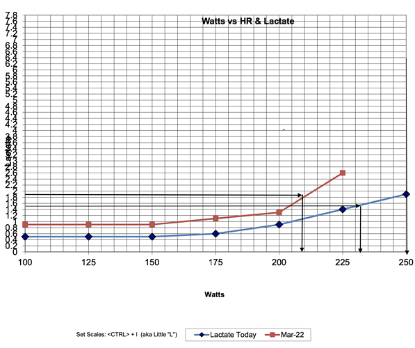

Hi guys, this discussion has been really interesting to follow. I would like to share what I have done so far on lactate testing, and what my plans going forward are. Any feedback/advice would be appreciated. First, I am a 56yo male, 88kg, 192cm. I bought an indoor bike (Wahoo Kickr Bike) last December and was “fresh off the couch” at that point. One of the first things I did was a TR ramp test and got an FTP of 181w. Also, right around that time, I had a local coach come to my house to do a bike fit and a lactate test. The protocol was 3min at each step, 20w steps:
You can see my lactate is already at 2mmol at 100w, and quickly rises to around 4mmol by 160w.
Next, I trained for about 11 weeks and went to a local university lab for a VO2max test in early March, and they included their version of a lactate test. Basically their lactate test only goes from baseline to the first 1mmol, with the protocol being 4min steps in increments of 25w:
After the first 1mmol rise from base, they continue the test as a VO2max test, increasing by 25w every minute to exhaustion. I was able to complete the 325w step and my relative VO2max was 47.1. The tech there very kindly also took the data from my December at-home lactate test and created a comparison chart of December vs March:
I continued my training and then returned to the university lab four months later, in early July, to get another lactate/VO2max combo test. Here is a comparison of the July result (blue) vs March:
In this test in July, the tech actually stopped measuring lactate at 225w where I was only at 1.4mmol, since it was a rise of almost 1mmol from my 0.5mmol baseline. So on this graph, the point at 250w is simply an extrapolation and not an actual measurement.
For the VO2max segment of this test, I was able to complete the step at 375w, 50w higher than four months earlier. Unfortunately, there was a problem with the mask (outside air leaking in), so I did not get a good VO2max measurement from this July test.
Anyway, that’s what I’ve done so far. This coming week, I plan to go back to the university lab to redo the VO2max test and hopefully get a valid result. I will get the lactate tested as well, but that’s not my main concern, and I’m a little frustrated that they stop the lactate measurements at such a low level.
For lactate, I have followed the advice on this thread and bought a meter. In a couple weeks, I am planning on doing a home test. My idea is to follow the ISM protocol of 10min steps, starting from 125w and incrementing by 30w steps to exhaustion, which I guess would occur at 335w or 365w. Any input on the home testing protocol would be appreciated.
That was interesting. Thanks for sharing. Did you train much around your LT1 between tests?
Yes, but it does not make sense to test for La when they switch the ramp to the vo2max test. the vo2max test requires these short steps. Too short for La.
I don’t think 10min are necessary. Perhaps for the early steps but it will get tough at higher intenstities. Going down to 6-8min works for these as well. And 30 W is quite a large step 2. I think step size should scale to expected exhaustion.
Apart from this, nice curves, always fascinating to see how this from-couch-to-trained works. Also quite shocking given that most people are fully sedentary these days.
