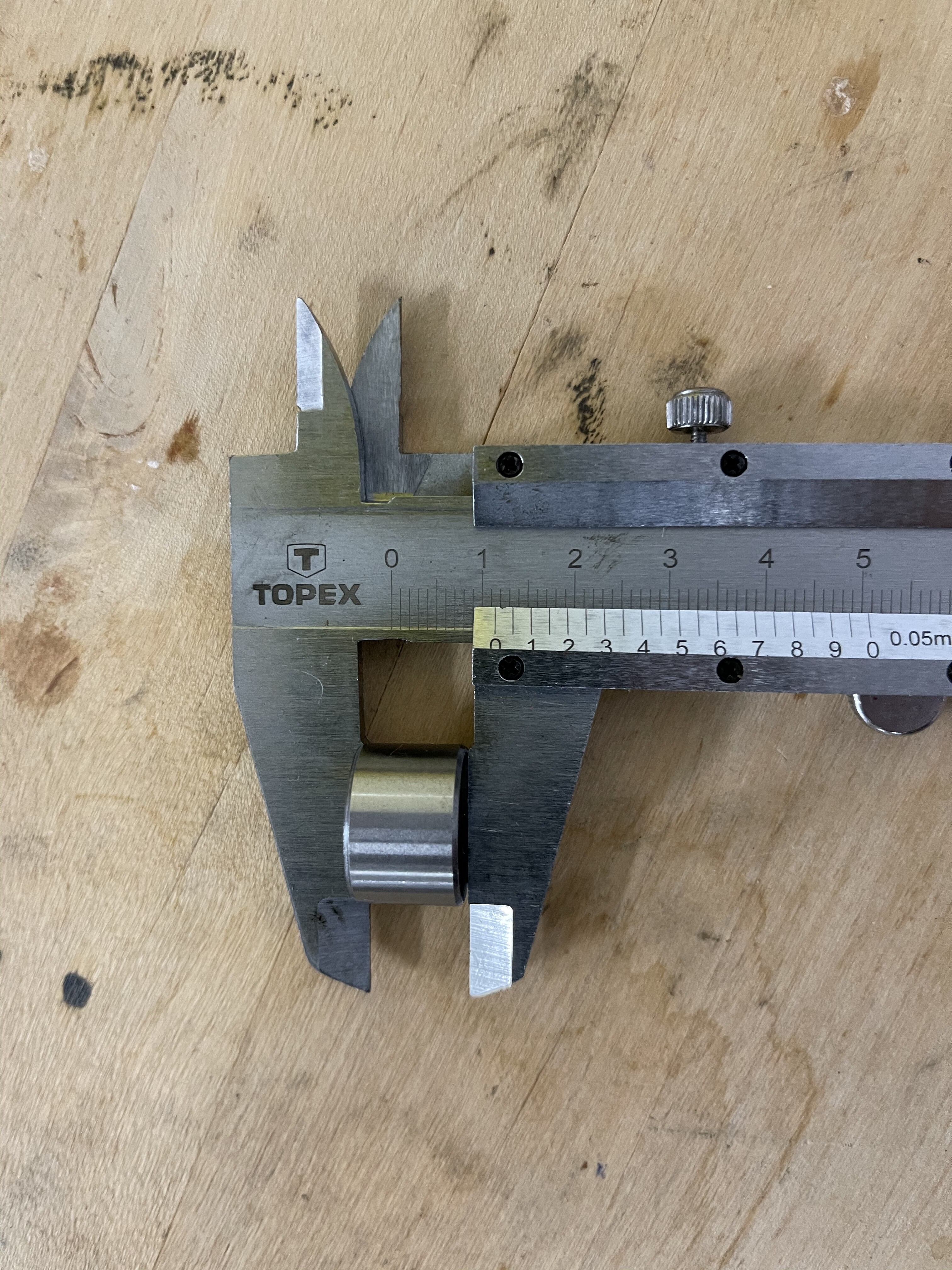

Hi there @CapraHam11 and @LiKuid! Any chance either of you could measure the proper depth of the new/unworn/uncorroded Kickr Gen1 shim? Is the inner shim supposed to be the same size as the outer shim? I am the lucky third owner of my 2014 Kickr and disassembled the cassette/freehub and shims for the first time today to clean all the grime out. After cleaning things up, I noticed the inner shim was much smaller than the outer shim and is also pretty banged up with scoring.
My partner had the idea to take the outer/intact shim to an auto specialty shop to see if they could measure and cut something identical to replace the worn down inner shim, but I am not sure what the correct size of the inner shim was originally. Any insight or help on this would be greatly appreciated!! Thanks in advance!
Hi there and Happy New Year! A bit late to reply, but here is the old vs new inner shim pics. Diff is small but makes quite a diff.
Old shim
New shim
If you manage to cut some new shims, i ‘d be interested in some to have in stock. Good luck!
