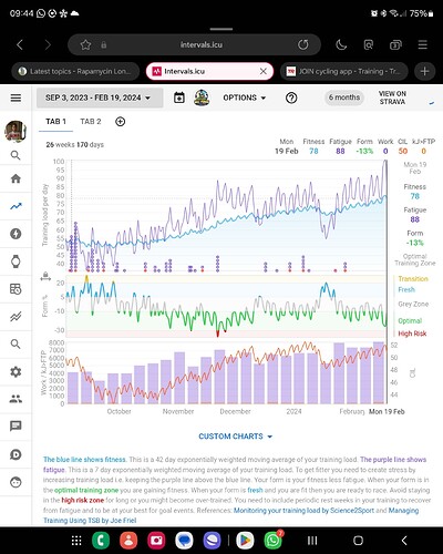

Looking longer term there definitely is some progression in not just ctl but also in intensity
(The 2 drops in ctl and intensity where a change from winter maintenance to lsrf and short illness respectively)

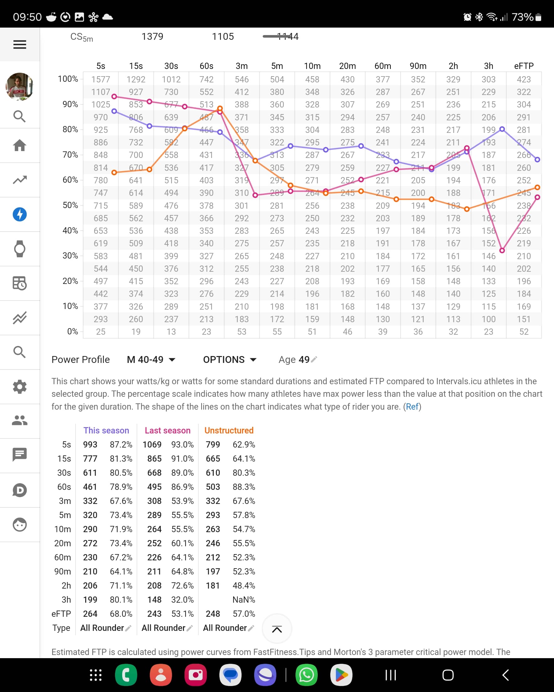

And here my power curves from unstructured, vs with tr and with join
