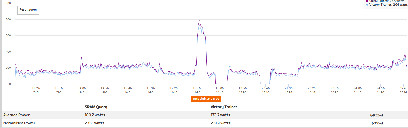

  • I dual recorded power, the victory was reading way under my quarq PM. I’ve tested this PM against my 4ii and my H3 trainer, and those 3 are all within a percent or two of each other. However, the Victory is consistently reading 8-9% lower. This is despite a spindown/zeroing of both power meters at the beginning of the ride, as well as a spindown after 10 minutes of riding.
Hoping the power stuff gets sorted out with firmware updates…I’ve seen on other forums people saying their Z2 rides felt much harder, thinking this might be why :slight_smile: At least it is consistently reading low so we can scale and/or adjust workouts for my wife whose bike doesn’t have a dedicated PM. If that’s the main issue though pretty happy with it overall.

Oddly it’s the opposite for me. The Victory was reading a solid 5-10% higher than I’d expect vs my crank based PM, but it’s so cold in my garage at the moment that I wonder if that’s playing a part in it.
I did update my crank PM firmware yesterday which has brought them a little more in line (maybe better temperature adjustment?), but the Victory is still a few percent higher than the crank PM.

Much happier with the accuracy on tonight’s session. I think if I’m honest the problem may have been with the crank PM (I had struggled to update the firmware as the app is garbage).
Differences were on bits were I stood up for a few secs and on the hard starts. I think it was 1.5 - 2% overall which seems fine to me for steady state… though there are some bigger discrepancies in the hard starts (more like 5-7%).
