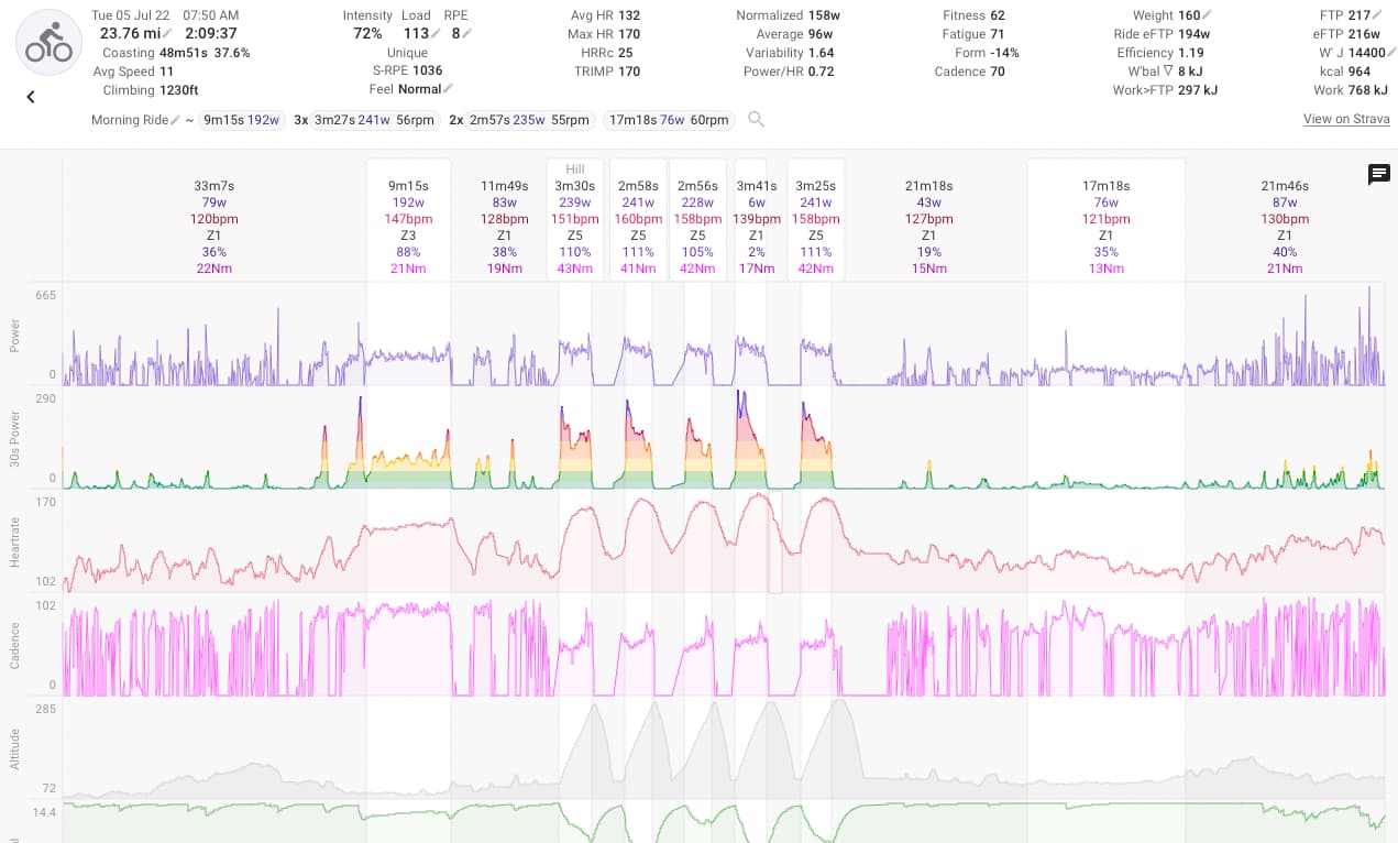

A few months ago, I had a bad crash doing VO2max outside. So now that I’ve built back up to doing VO2max, I decided to do them on a steep hill to keep the speed down.
I wonder about opinions regarding this last workout…?
Here is the workout in the context of the entire ride:

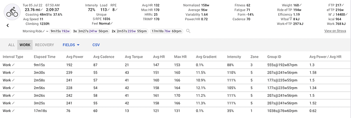

And here are the details:

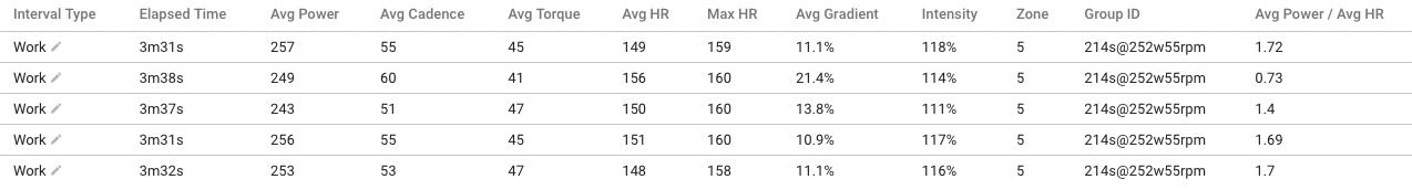

What troubles me is the cadence. The hill is steep enough (around 20% for a bit) at the start that I’m grinding away at less than 60 RPM, with high torque (over 60 for a bit) although it eases off towards the top. As a relatively weak, early 50s rider with a suspect left knee, I think this is probably not a good idea.
Although it certainly feels like a good VO2max workout, am I really getting an appropriate aerobic stimulus from this hill, or should I find my courage and go back to a flatter area where I can spin at 90+ during over-threshold efforts? I know I’ll get some good short-term gains from doing this once per week, but perhaps I’m shooting myself in the foot with this low-cadence, out of saddle grinding?

Regarding the intervals themselves, if they are meant to representative, the power is a bit low. If you do 3-minute long intervals, you should be around 120 % FTP, not 110 %.
Lastly, you mentioned you had a bad crash while doing VO2max work. It is essential to have suitable routes for each workout type. Especially hard VO2max workouts and hard, long threshold intervals require concentration just to meet your power targets. Navigating terrain and traffic can become difficult. I prefer to do such hard workouts indoors.
Thanks for the tips. Yes, I can do (and have done) them indoors, but in the summer heat/humidity, I want to exercise outdoors as much as possible. I like to do the workout as part of a longer, pleasure ride since I’m not a bike racer and performance comes second to enjoyment.
Is it optimal long-term to maximise gains? Probably not. Were you breathing hard, gasping for air? If yes, then it’s good vo2 max workout. They are rather low on power given low cadence but as long as breathing is there, do what works for you.
I’d disagree with @OreoCookie. 120% isn’t a hard and fast rule. 110% looks like it’s working for you at the moment. You seem to be hitting you heart rate goal (assuming your HR zones/max are set correctly). It looks like you start your intervals hard, which is good as it ramps your HR up quickly.
Personally, I find that returning to VO2 work the first couple of sessions I’ve no bother hitting HR goals. After a while though it gets a lot harder. You’re going to need to extend the duration of the intervals and use a higher cadence to help drive up HR. So I’d prob look for a shallower hill. If you have something between between 4% and 8% near you it would be perfect. It’d make it easier keeping your cadence up.

It feels like a good VO2max workout for me at this point. Just worried that I’m missing something by not spinning at a good cadence.

I am not sure whether your low cadence is the result of fatigue or unsuitable terrain, but if you have to grind just to make it up at VO2max power, your hill just might be too steep.

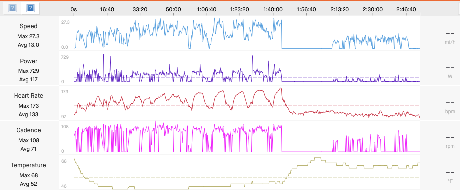

In the 5th interval, near the end, I went through a bad section of curving road where there is only one safe line (because of water-filled potholes). Due to fatigue and complacency (and distraction caused by passing a loose dog a bit earlier), I somehow missed the safe part of the road and got onto the loose, gravely shoulder. It was completely avoidable and unnecessary, but like @OreoCookie alluded to:
I had been through that section of road multiple times, and I knew how to do it successfully, but at max aerobic, I wasn’t thinking clearly. I came off the bike in soft dirt/gravel, and landed head/shoulder first onto a guardrail at 25mph+. The bike was fine but my helmet was trashed.
Here is what a crash looks like on my Garmin lol:
I managed to ride home at the end, with some help from some good guys, then spent 4 days in the hospital.
This road where I crashed isn’t the best for fast riding (at least for me). Thankfully, I have a safe, straight section of road (with negligible traffic) where I can get about 3 minutes, I will use that in the future (even though I am loathe to make a fool out of myself with high-intensity exercise in front of all the joggers and dog-walkers who frequent that area).

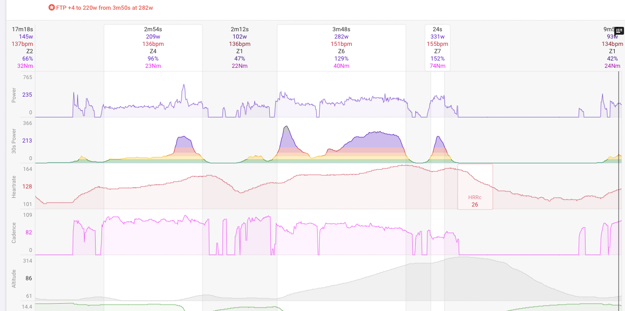

Two days ago, I climbed a hill and I may switch to that hill since it’s a bit better cadence-wise. Traffic might be a problem though. This was the hill:
Or, maybe I’ll go to the relatively flat section where I can get 3 minutes safely. But I want to do my original hill at least one more week.
