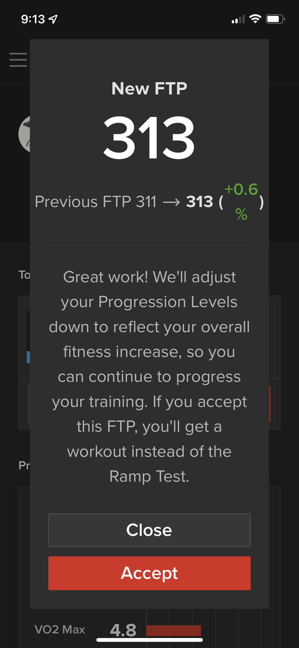

As suspected the FTPd was off. On initial rollout it appeared accurate at 317. However after week 3 & 4 of SusPBHV1 the FTPd kept decreasing and this morning it said 313. If it was still 317 I would have probably skipped the Ramp Test.
Maybe 2.3% difference (313 vs 320) is within the acceptable margin, but FTPd as of now seems not quite dialed.
