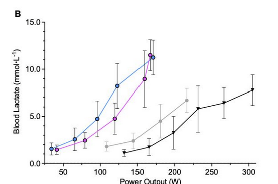

On the existence of a baseline, I found this quite shocking. One of ISM’s most recent:
grafik
from left to right:
  • post covid with comorbidities,
  • post covid w/o comorbidities,
  • metabolic syndrome,
  • moderate active
This bug is nasty
https://www.atsjournals.org/doi/full/10.1164/rccm.202108-1903LE
Just to throw a wrench in there, my hr at lt1 is only about 70% of my peak hr from the last few years. My endurance rides are at an avg hr of like 110, but i mostly just institute a cap of 120 fir my “easy” rides. Breathing rate is still relatively easy, but has increased from the baseline.
Yes very good exemple of what I am saying just before :+1:
