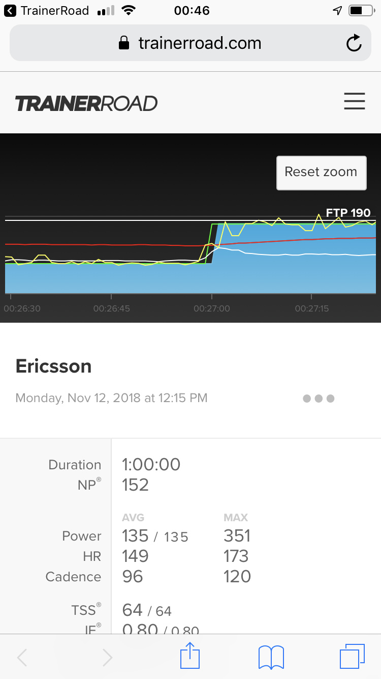

I have a Tacx NEO and I have a similar issue. Not bothering too much, but maybe I should ?
Basically, on short sprints, like the one I did today - Fuji, 20 secs at 200% FTP, I notice that:
  • the resistance seems to adjust immediately
  • the yellow line (actual power) is adjusting only 3-4 seconds after (it’s gradually going up to 200%)
  • it seems to ease up 1 second before the interval end (this one is strange ?!)
  • all this causes my average power to miss the target by 20 watts on average
Frankly, I think it’s not that important, but it sure is a bit frustrating.
I have a Tacx Neo, too. Intervals consistently start 2 seconds early (which sometimes still surprises me) and end 2 seconds early. The latter also surprises me, but usually in a positive way. :slight_smile:
Especially at the start of each interval the target power is way off (too high or too low) and will only slowly move to the desired target.
Nothing that frustrates me much but seems like an odd QA glitch in an otherwise flawless product.
Looking at your 1st interval zoomed in:
Looking at the yellow ‘Power’ line:
  1. You can see the slight delay as the trainer ramps up resistance.
  2. It overshoots, which is common, and then settles into a stable finish.
  3. Then it extends just a few seconds past the blue interval block and drops.
All of this is pretty much intended and acceptable. The shifts we see are nearly impossible to remove entirely.
  • It reduces resistance early for the reason I listed above (because it starts early), do the overall “effective resistance” is done for the same overall time period.
  • What you experience on the Neo may well differ from other trainers, because it uses a “virtual” flywheel compared to a real flywheel on every other trainer.
  • That flywheel difference may be the outlier compared to the more consistent (and possibly larger) delay we see on real flywheel units.
