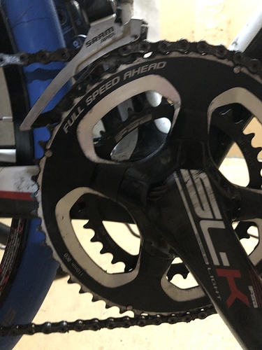

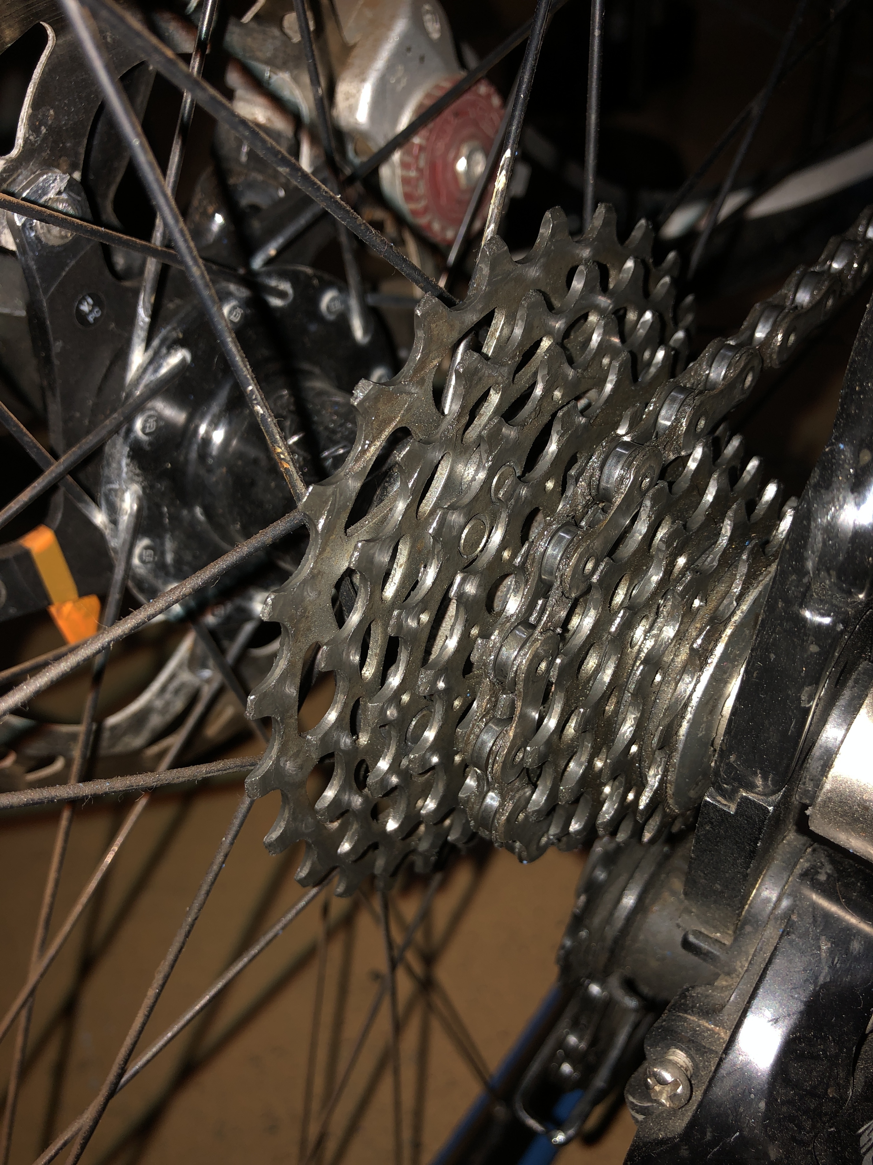

I’m not quite sure what the relevant bits are. Here are some pics.
I am also requesting suggestions of names of shops and suggested budget for “crappy indoor wheel”. My main intersection is Yonge and 407.
Yes. I need to speak to a shop that can look at those details and spec out what will work. Open to shop names to call/visit. My bike started as Rim brake and was converted to disc. Maybe my spacing is non-standard and scares someone who looks at it.
Since you have quick release, you could possibly get away with what you are proposing. I’d measure the spacing between the dropouts. If it’s 130mm then it’s the standard road 11 speed rear width and you’d be good to go with most any 130mm rim.
The other thing you’d have to be cautious of is if you pull the rear brake without a rotor in it, it might move the pistons too far. I used to have a mountain bike where if I did that, I’d have to take the pads out and manually push the pistons back. And you could always put something in there to block the pads/pistons from moving too far.
The rear axle standard is 135mm wide, quick release (9mm axle diameter IIRC). It is a standard 700c rim diameter.
That axle is what old MTB and early road disc brake bikes used. There should be some reasonable prices on wheels for that. Even old XC 29" MTB wheels can work.
I no longer live in Toronto, and when I did I was exclusively into mountain biking. I lived near Yonge and Eglington, and there was a Trek shop close-by. It was alright, but I preferred a smaller MTB shop in the then newly developed area by the lakeside.
It looks as if you have a wheel with quick release skewers, so like @mcneese.chad said, you should have a wide choice of wheels. And indeed, you should be able to use rim brake wheels for training purposes. I’d put a shim in between your brake pads, though. (This is a must for hydraulic disc brakes, but even for mechanical disc brakes like you have, this should be good advice.)
