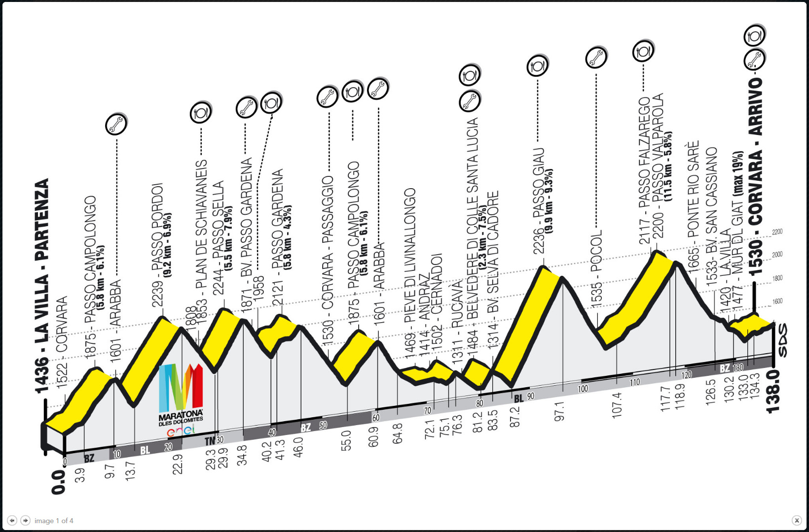

I have been cycling for ~30 years. Initially just recreational MTB touring in the Alps. Live in Munich, Germany. i.e. have some very nice cycling terrain fairly close to me.
7 years ago, I started also road cycling. I have participated to Maratona dles Dolomites (138km, >4000m vertical climbing) 6 times now. Have not done any training apart of jumping on my bike during the normal cycling season and trying to get as much mileage on the bike as time permits. Initially flats around where I live and then as my form allows, long road bike tours in the mountains.

After the Sustained Power Build plan, I have a 8 weeks Climbing Road Race specialty plan.
After that 1 week of rest (no work outs at all) and the following Sunday my main event, Maratona dles Dolomites 2019.

The event definitely has long climbs. It pretty much is either climbing or descending.
I will look in to the description of the training plans again, but perhaps the century plan would really be the way to go instead of the Climbing Road Race specialty plan.
