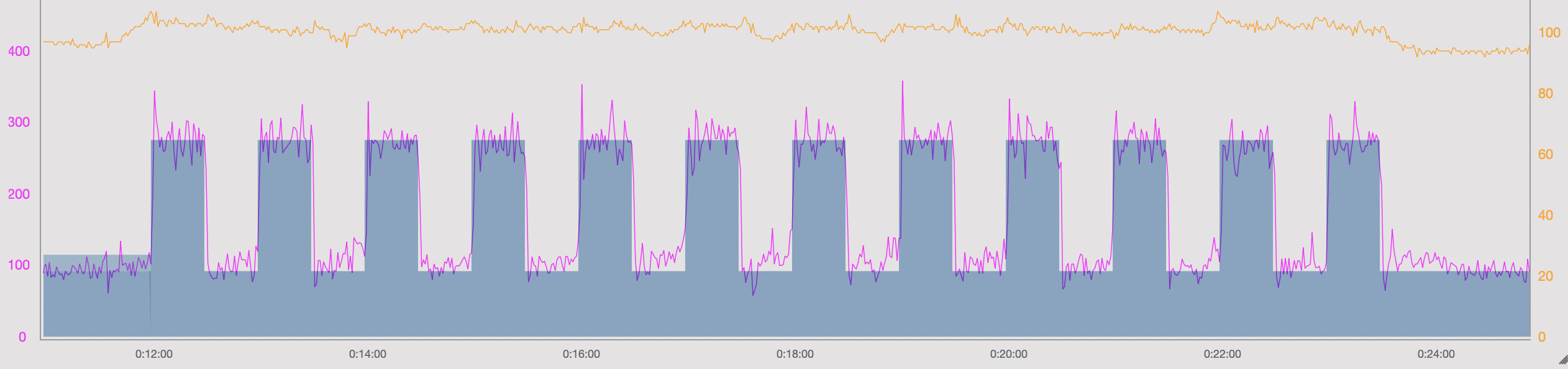

Just adding another reference workout (my most recent SN from 2020) that I did in ERG with my Kickr17, 34t x 17t as I use most of the time.
As others have mentioned, you can kick a bit on the cadence side to get these to work. But generally speaking, the more stable and consistent you hit your cadence, the better the whole ERG system will perform.
Mine above is in the small ring (34t) and lets the trainer work faster and better when compared to a higher gear and flywheel speed. However, I still think it can work in that higher gear if you hold your cadence well.

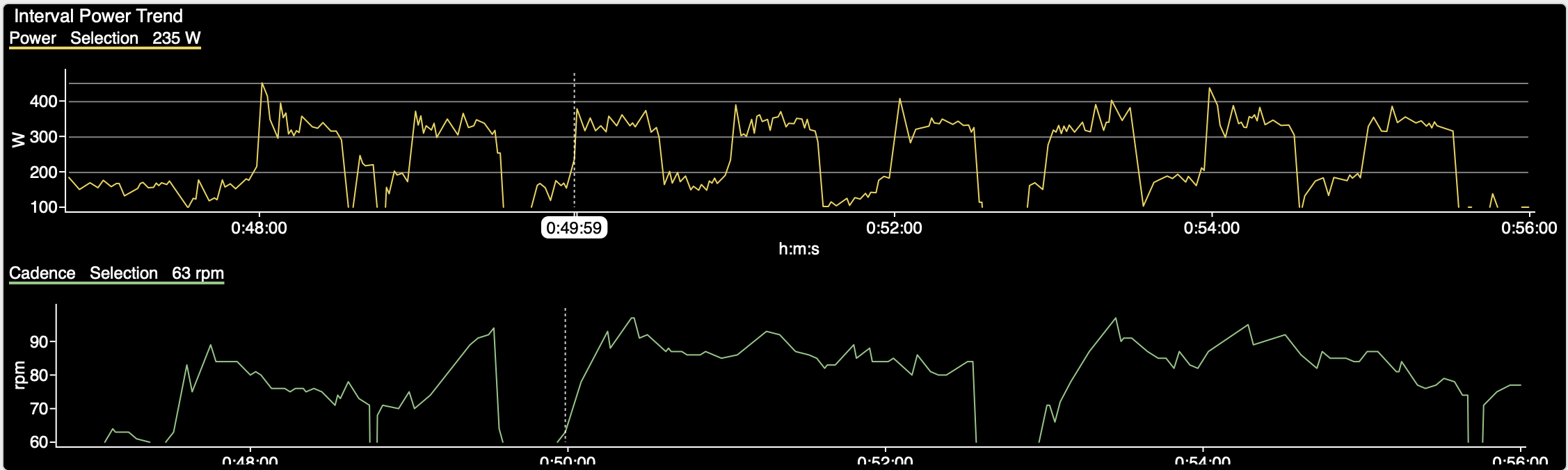

Looking at your screenshot, it seems you are kicking hard, and then still increasing cadence through the interval. Not sure why this is happening, but if you are “chasing the power”, you should try not to do that.
Just ignore power entirely. Choose the cadence goal you have, hit that early and hold it for the entirety of the interval. The constant change in your cadence is “hurting” the results since you are constantly forcing the system to adjust the resistance unit to hit the power target.
  • Nope, your power data shown there has nothing to do with gearing. Those workout lines are purely the result of a massive level of power data smoothing. It is available in some trainers, but most often seen with Wahoo trainer since they default to using that setting.
  • Watch the video below for reference, and I highly recommend turning the ERG smoothing OFF so you get more appropriate looking power data.
  • https://youtu.be/7L7hfT0I7E0
  • Based upon the fact you (ChrisDe) have an old Elite trainer, it appears they also were fond of adding some massive smoothing to power data. I am not sure if Elite offers an option to turn that off, but I’d sure do that if at all possible.

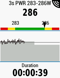

First off you need to think in terms of a range. My Garmin was showing a target of 299-354W so the center was about 325W. Looks something like this but with a 55W green zone:
Narrow Target Threshold
The ‘game’ is to keep the triangle in the green, in the pic the black triangle its at 286W, and for the interval above the green zone was 299-354W.
