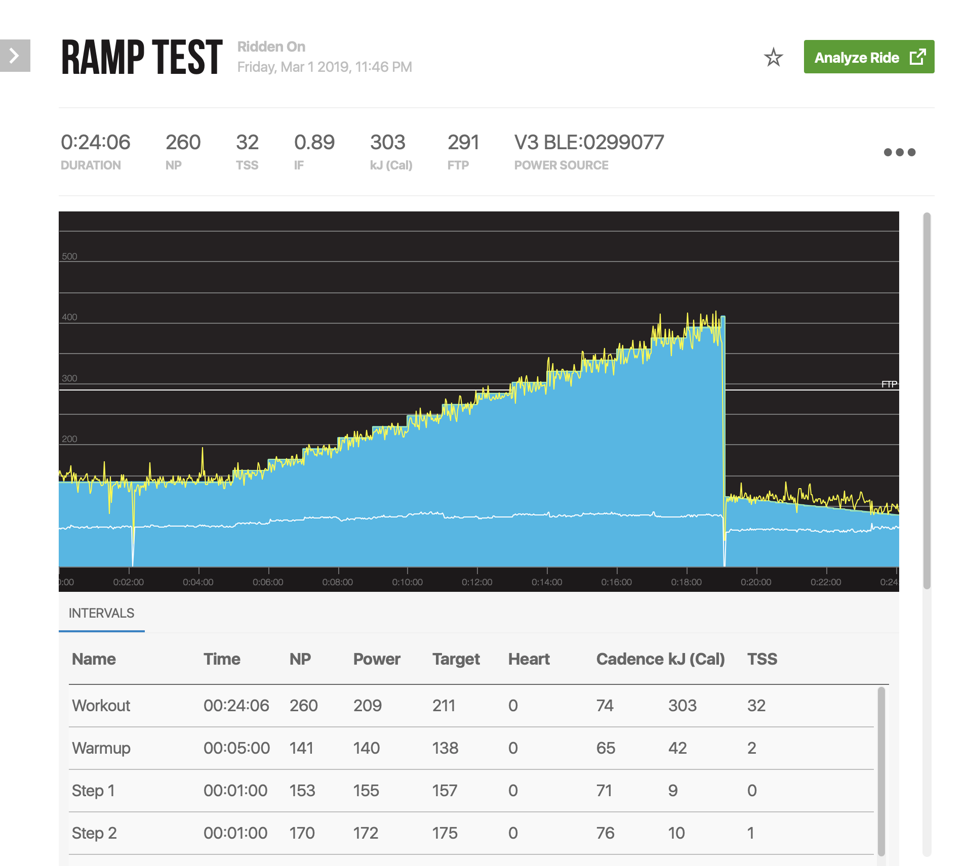

OK! so finished the marathon on Sunday, took me till Wednesday to not feel any pain in my legs, and had Time tonight to do the ramp test finally. Im pretty happy with the results as a good starting point to build from. I hit 291w, and nearly ate my dinner for a second time, so I know I laid it all out there.
Ive got until April to get that FTP up to a competitive level. im currently 167lbs, so im sitting at 3.84 w/kg. my peak was 4.0 last summer doing mostly unstructured mountain biking outdoors with the occasional TR trainer ride indoors.

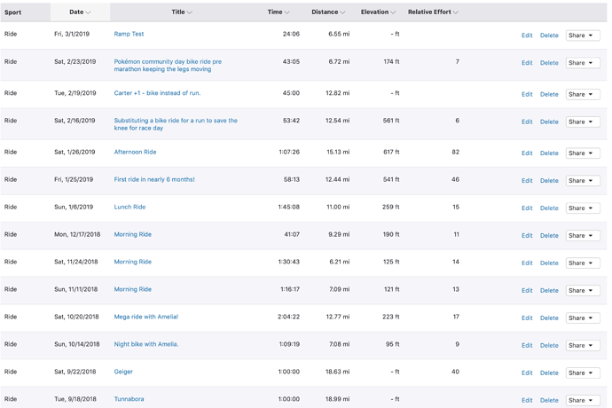

my Log of biking since September. Most of these rides were with my 4 year old daughter…(i.e. super slow) 1 commute to work when my car wouldn’t start, and two easy rides in the last two weeks because my IT band/knee was giving me issues before the marathon.

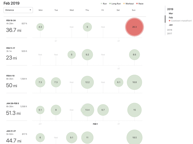

my run log is obviously a lot longer, hitting 40-50 miles a week almost every week since September. December was the only exception to that.
