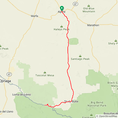

Long story short I completed in ultra distance races until 2015, when I had a massive health issue. Been back on the bike since 2020 and I’m ready to test myself again. This 200 mile race is close, but at 104kg/230 pounds I’m not a climber so this sucker is a little scary! . Most of the 11k feet of climbing is in the second half. I’m currently doing the climbing road race plan, but I’m not sure how TR accounts for races over 12 hours, and with a profile such as this. Should I make changes to the plan? I’ve got a little more than 3 months to train. Thanks!

Also, it looks like most of the climbing is pretty gradual, but I’d definitely err on the side of the lowest gearing possible if there are any steep bits. Walking sucks and it will be a long day.

The only other advice I’d give would be to ensure that you’ve got enough gearing to get up those climbs late in the race. If your gearing isn’t low enough, you’ll have to produce more power than you’d like to get up the climbs, which could make or break your race.

My gearing will be 48-34 and 10-36 given the climbing disadvantage I have - and the fact that I’m so big. See you out there! I’m certain I’ll be the only bent in the 12 hour. I have a bud doing the 300 though.

The elevation grade doesn’t look too bad. Obviously don’t burn out your top end in the first half. Fwiw, I think the optimal climbing strategy changes for us heavies. Slow grinds out of saddle can be more energy efficient, in my experience, with some practice. For me, sustained double digit grades is when walking might be a better use of energy. I actually drill marching up 15% inclines on the treadmill ahead of certain races. But the profile doesn’t look crazy on what you’ve linked.
