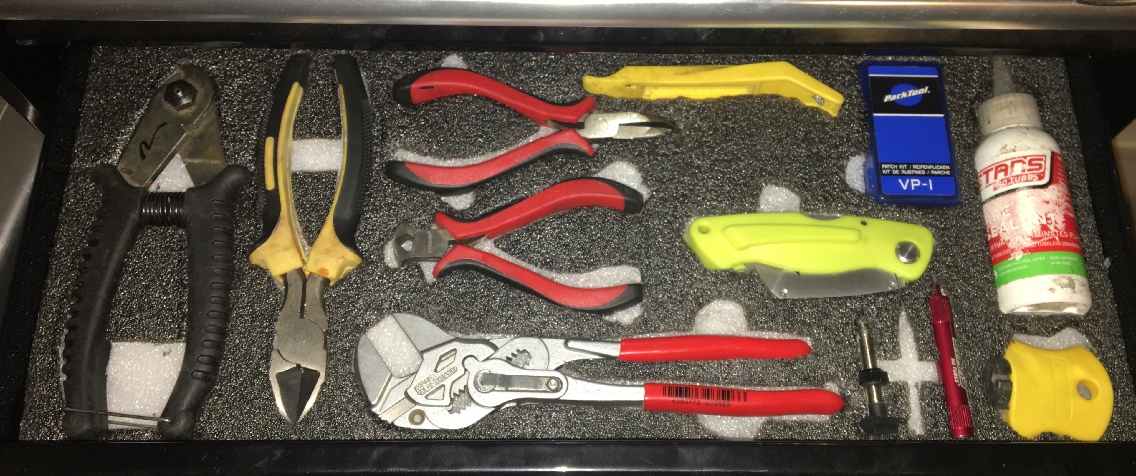

Middle Drawer
- Cable Cutter
- Diagonal Cutters
- Needle-nose pliers
- Flush ZIp Tie Cutters (non-essential)
- Knipex Pliers (My favorite tool)
- Tire lever
- Razor-blade knife
- Tubeless Valves
- Stans Valve Core Remover
- Patch Kit
- Stans Mini-Bottle (for adding sealant through valve)
- Spoke Wrench (make sure it’s the size of your nipples)

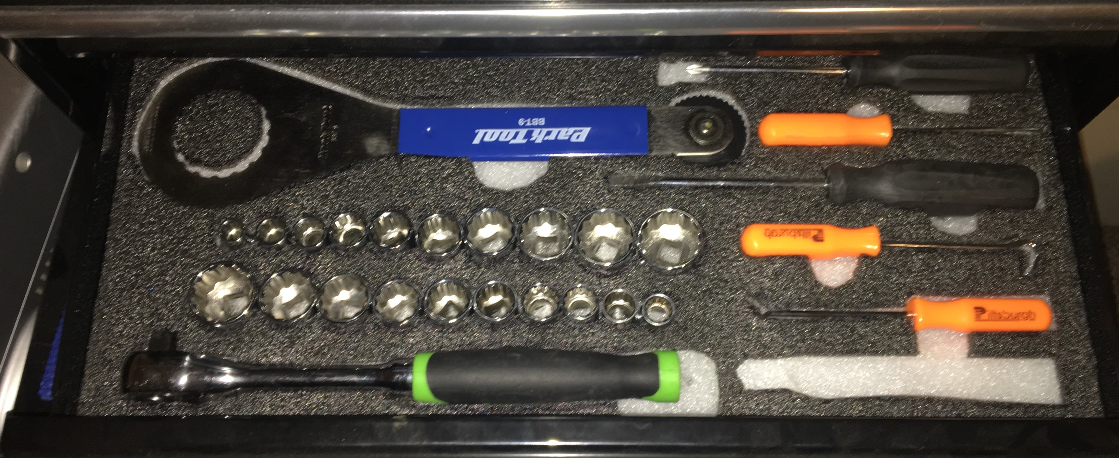

Bottom Drawer
- Bottom Bracket Tool (useful for BB and some centerlock rotors)
- Full Ratchet Set (not strictly necessary for bikes)
- Various Screwdrivers
- Various Picks
My particular toolbox setup uses Kaizen Foam to hold each individual tool. This takes up more room, but keeps everything from shifting in the toolbox and lets you know when you’re missing a tool. And it really satisfies my organizational impulses.
