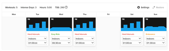

Can I ask another question for my next training plan? I noted that TrainerRoad suggests a 5-day training plan for me but one day is a 30 min super easy endurance ride (see below). Is that actually productive? I heard an interview with one of the 80/20 proponents who stated that a recovery ride is not more effective than just rest. Could I cut that day? Maybe make the other endurance ride longer? Having less training days to fit into my work schedule would reduce stress much more for me than making the workouts easier :wink: Or do you believe that this short Z1 ride is actually important and it is better to do one 30 min and one 1:30 hours endurance ride?

Those recovery rides can actually be really beneficial for your recovery, but they might not be as productive in the same way as your really hard workouts.
If dropping down from 5 workouts a week to 4 is going to help you significantly manage your stress levels, then I’d say you should definitely do that. At a certain point, adding more work to your week becomes counterproductive, and it’s important that we know where that line is and respect it.
With that being said, it doesn’t make sense to take the work from the workout you’re cutting and adding it to another day unless you’re going to be able to sustain it throughout your plan. Sometimes cutting that extra day isn’t going to help much if you’re still doing the same amount of work in the week.
In short, my advice is to cut that easy recovery ride if it’s going to significantly help you manage the rest of your week, but maybe skip adding the volume to your endurance day for now, until you’ve become really consistent with the work you already have.
When you go back into Plan Builder and switch from 5 to 4 workouts a week, TR will likely give you the most appropriate schedule for your current abilities anyway, so don’t worry about manipulating things too much. We’ll take care of that for you. :slightly_smiling_face:
