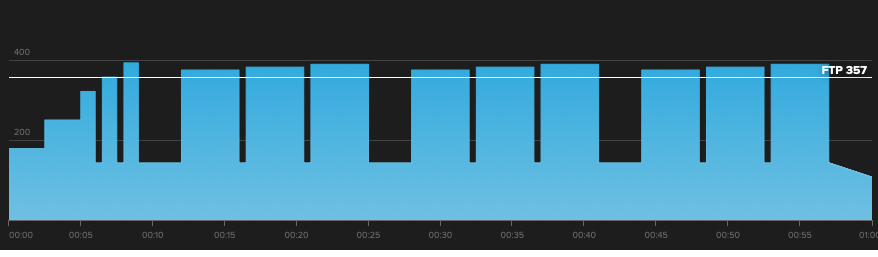

I had my first workout fail in quite a while this week: Spickard+1. I managed the 1st block, but was then just totally gassed; ended up bailing and doing another 30 min of endurance.
I was kinda bummed about this, but turns out that first block was my all-time highest power output for a bunch of durations 10-13 minutes. Average power for that 13.5 minute block is 109% FTP. This made me wonder: for an athlete working with an approximately-correct FTP, is 3 repeats of this reasonable or feasible? Or am I just bad at threshold work (or has AI set my FTP too high)?

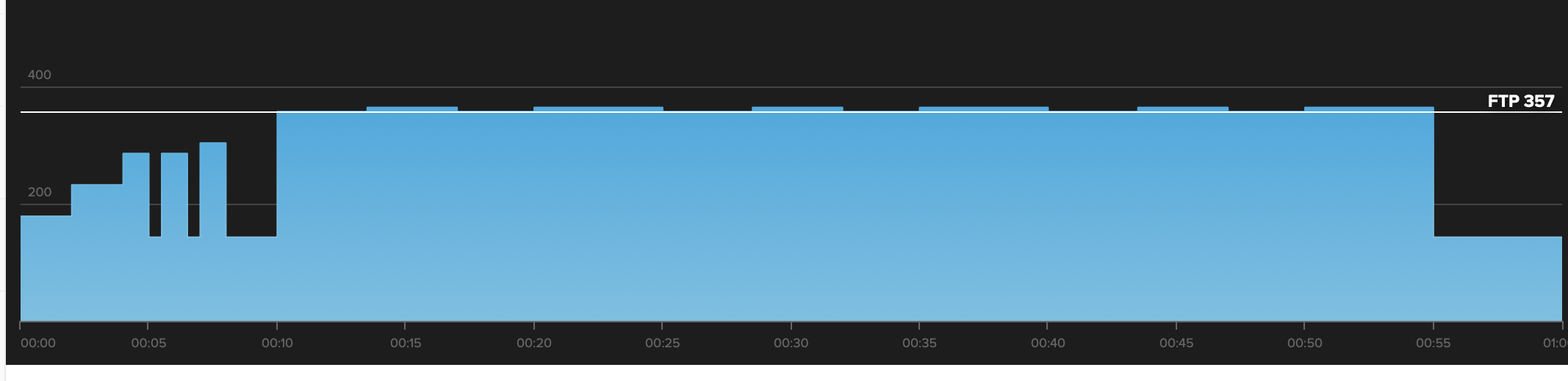

If Spickard looks bad, check out Haba:
I was under the impression that 45 minutes at FTP should be a VERY hard effort, so this workout doing 45 minutes of over-unders where the unders are right at FTP seems borderline impossible.
I know, “I failed a workout so it must be impossible, waa waa waa.” I guess I’m just curious of others see these efforts as feasible, or if the assumption is that once you get to this PL your FTP has actually improved enough relative to the last AI test that these are doable (and mine hasn’t, apparently.)

Ha, I hadn’t noticed Spickard has a 101 TSS, that does make me feel a bit better!

this is a case where i would wholehartedly agree that if you’re completing this workout, you’re ftp is set too low
and Haba is so similar to actual ftp, that you may find power meter margin to be in adequate to compare between ftp and that 1-2%.
I think Haba looks tough but doable. Yes they’re over-unders, but the “overs” aren’t really that high so it’s essentially just a 45 minute block at threshhold which should be achievable with a correctly set FTP.
Spickard looks much more intimidating to me - I doubt I could do that one either. I find 2.5 minute efforts at 118% challenging even without having to sit near threshold in between. That being said, the ability to recover just below threshold is something that can be trained so I’m sure it’s possible for some, especially those with a stronger v02 max where 118% isn’t such a tall order.

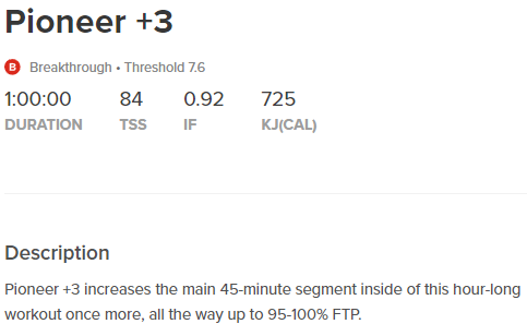

The fact that Pioneer+3 and Spickard+1 are both Threshold and at the same PL seems inconsistent to me. Pioneer seems very doable, Spickard seems impossible (to me.)
Musgrave, a PL8.7 VO2 workout, actually looks a lot easier than Spickard+1!

Huh, Spickard+1 just looks wrong for that PL, and maybe that it’s threshold at all. The ‘overs’ are at 118%.
I agree, that seems like the outlier to me and could be the “wrong” one WRT PL’s.
I’m with others; if you complete Spickiard+1, then the FTP you based it off isn’t your FTP.
I can see Haba being doable as a flat-out effort for someone with an accurately set FTP, but I’d guess it would be pretty much at the absolute limit.
If it’s generally agreed that some of these workouts are not possible without an incorrect FTP then I wonder what the point of having them is?
The variation is so small that practically speaking this is riding at FTP for 45 minutes. Not over-unders.
