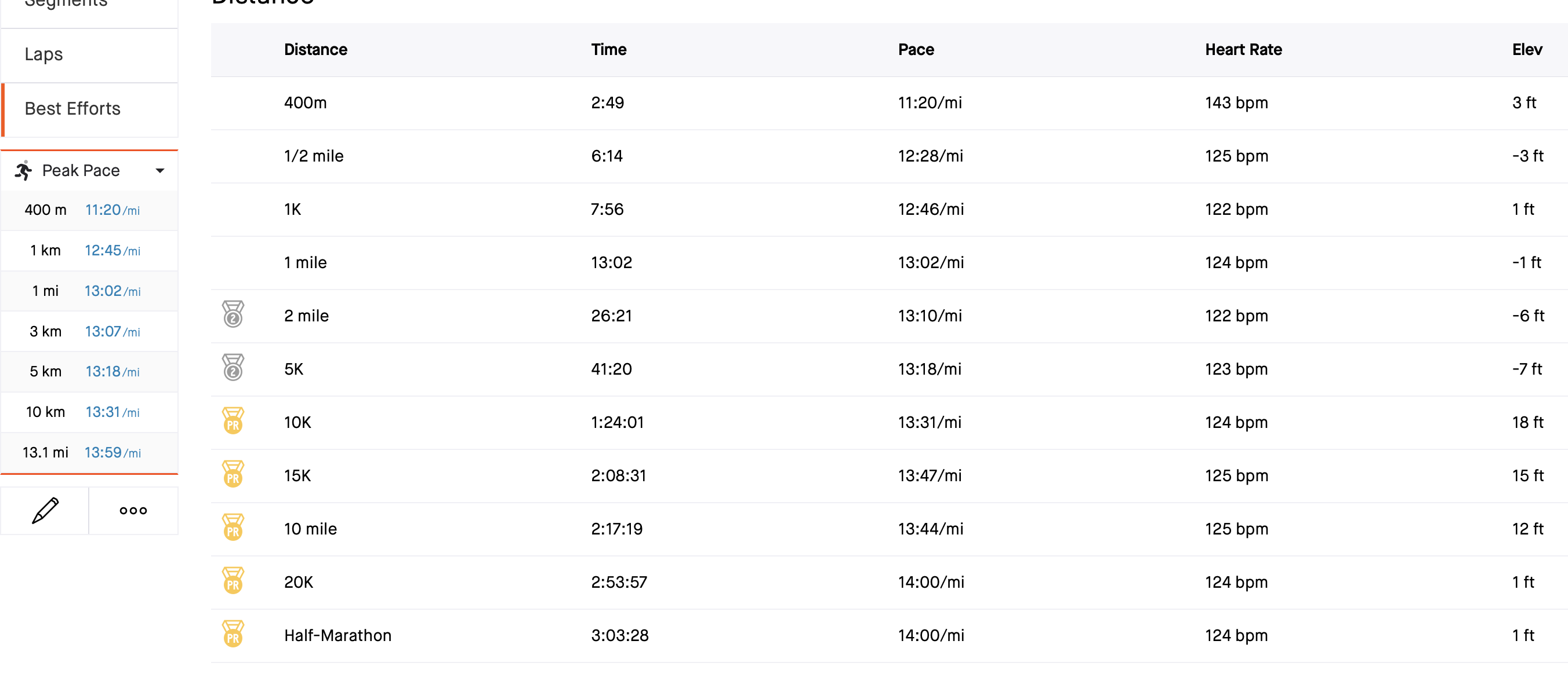

9 years ago I power walked a half marathon at 2:59:58 but had to jog the last minute to break 3 hours. Thats when I decided to take up road cycling. Toggled this to a run so Strava would give me some splits and PRs:

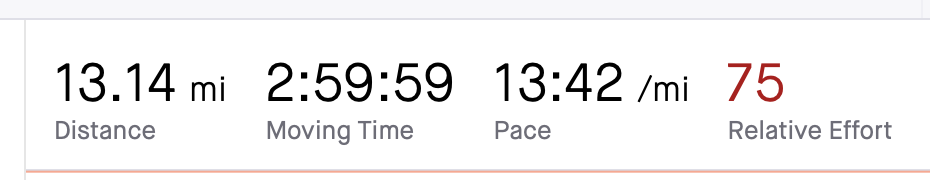

Shoot, guess I stopped a couple times. Power walking except for the end. Guess I remembered Strava’s hero bar:
Crushed right now… I guess thats not too shabby for a 90-95kg old dude, do I have to try again? Cycling is soooo much easier on my body!
