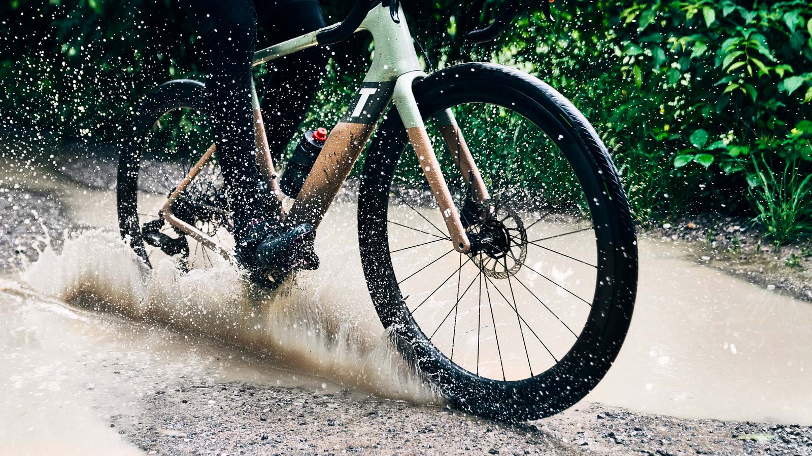

A wheel that is missing from your list is 3T’s Discus 45|40 Limited, which was to my knowledge the first gravel-specific aero wheel. It is aerodynamically optimized for 35–40 mm tires, but can obviously take wider tires. (Optimized refers to the 105 % rule where ideally the wheel’s outer width is at least 105 % of the tire width.)

Josh Portner has expressed his approval of the 3t discus 45 a few times. 45mm deep and 40mm wide external so they’d still seem to satisfy the good ol’ rule of 105 with a 35mm tire if that is indeed the WAM. Not cheap but not the most expensive either.

What tire do they have on that 3T?
Looks like Pirelli’s Cinturato velo
