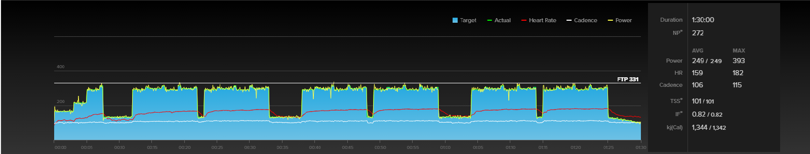

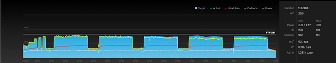

Having same kind of problems as described above. I have been riding on trainerroad for two years, mostly MV, summers outside, assiomas indoors and outdoors. Max HR 195, LTHR 175. Started riding indoors again 3wks ago, did a ramp test at 331w. I’m doing a MV/HV hybrid, MV rides on monday, wednesday, and friday, others HV. Now on SSB1. Have two big fans and a window.
Did a Carillon +2 yesterday, HR was steadily climbing on the intervals, first two reached LTHR towards the end, second two at the half way and last to before the ahlf way, maxhr being 182. Ride felt pretty hard, not feeling like I could do the same tomorrow, the day befor was 34TSS 0.67IF
Last week during Geiger +2 I had to tone down the intensity, HR was almost at LTHR on the first interval. Other rides I did outside.
Both times my leg were burning towards the end. Last year I dont remember SS being this hard, is my FTP too high or have I just forgotten how it should be?

If you can’t do 5x12 sweet spot with 4 minute rests, then barring any life factors like lack of sleep or very bad nutrition etc, yes your FTP is overestimated.
I suppose it is, cannot figure any other reason myself. I did ride 40min at 328w average few weeks ago and felt like could have done an hour, had to stop due time constrains. That was outside, so little bit apples and oranges. Also last ramp test I felt great, so that might have been just a fast day.
Thanks for the help and confirming my suspicions, I’ll drop my ftp by 10w or so.

I think I could have done the the Geiger +2 as it was but it would have been quite an workout, surely next few days would have been only for recovery, didn’t seem that purposefully. I’ve tried SSB1 HV once 1,5 years ago, couldn’t do it fully, it was hard. The rest week felt really nice after that. Bounced back to SSB2 MV after that, for me it feels like there is quite a jump between MV and HV.
I’d say that’s on the higher side. Even while not knowing anything else about you, statistically speaking this is probably more in your high threshold to even low vo2 range. Being that it felt hard but doable means you may have been pretty fresh with minimal fatigue from recent efforts from days prior. But to repeat this for a few days straight or even week after week will begin to wear you down. But if you have a lot of fitness to gain, this was probably a good ride for you. Shoot for a HR in the lower 160’s for consistent sweet spot and work to get more minutes in, in that range.
I can definitely see why you’d think the 331W FTP estimate from the ramp test was reasonable then!
Since you mentioned your indoor setup has sufficient cooling, I can only imagine it coming down to how steady the 40min was + your anaerobic capacity being good, and/or your TTE @ actual FTP being a fair bit longer. Either way dropping by 10W and seeing how it goes sounds like a decent plan, good luck and let us know how it goes :+1:
