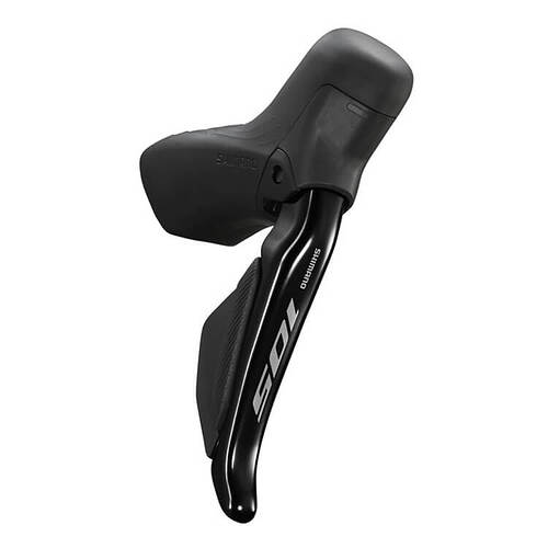

I have a 2023 Canyon with 12 speed 105 Di2. Lately I have had issues waking the system up when starting a ride. Usually it requires one click, on both left and right shifter, to wake the front and rear derailleur up, and then it shifts normally with the next clicks. At some point it started requiring 7-10 clicks and then even more. I updated the firmware and changed to new batteries in both shifters. That fixed the issue for a while but now it’s back again. Before today’s ride it took 2-3 minutes of furiously clicking before I got it working. When it first wakes up it shifts with no issues for the entire ride.
A couple of hours after today’s ride I testet the shifters again and this time the front derailleur woke up after one click but the rear derailleur was completely unresponsive. I checked that the cable to the derailleur was securely fastened and the main battery works as expected. I tried removing the shifter batteries and when putting them back in the rear derailleur woke up at once. Anyone had similar issues or have some tips to what the problem might be?
