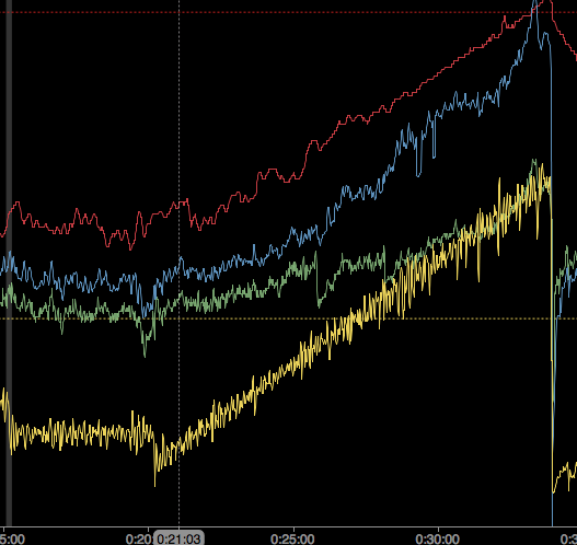

I think the criticism of TR original SS base plans was misplaced. The problem was actually the ramp test.
TR claims that the ramp test mostly underestimated FTP. This is probably because there were a lot of new/inexperienced riders trying ramp tests that just didn’t know how to really dig to the finish. All of the newer cyclists I referred to TR admittedly left a lot on the table in their early tests.
On the other hand, cyclists with more experience digging super deep in structured training tend to see their FTP overestimated in ramp tests because they’re on the other side of the ramp test accuracy bell curve. This is true for me and many other experienced cyclists I know. These are also the athletes more likely to choose high volume plans. Thus they end up doing huge threshold blocks rather than SS blocks and burn out.
I think the old plans would work much better in the age of AI FTP detection.
I think it’s that cyclists with better than average anaerobic capacity can easily game the ramp test. ISTR that the original ramp test researcher said that ftp was a range (like 70 to 80% or something) but most applied applications just took 75% thus half under test and half over test.
I also think sweet spot plans sometimes attract a certain type of hard man rider that likes to suffer in longer intervals. People never figure out that sweet spot should be a 6 out 10 effort, not a 7 or 8 out of 10. They grind out those intervals at 8/10ths because the fatigue feels good until their training falls off a cliff.
I am not sure how it would work but some sort of weekly feedback to athletes to indicate level of overall compliance may help people understand where they are falling short. It could be weighted for the key workouts.
Neither reason needs to be mutually exclusive, but depending on the cohort, one may be dominant over the other.

Anaerobic capacity is the physiological reason. Refer to the original ramp test literature. You are supposed to go all out.
Your wife’s HR change is a sign of fitness and has nothing to do with any of this. If anything noobs will under test. I was talking about over testing and the reason why.
Lots of coaches prescribe intervals by RPE. Five hour trainer rides has nothing to do with the conversation at hand.
No, it isn’t just fitness, it is that my wife never got to threshold. A fitness Youtuber had his wife do a gas exchange test untrained. Same there, she never got to threshold even though she went as hard as she could.
That’s what @patrickhill and I were talking about. Your point on anaerobic capacity is exactly what @patrickhill wrote in his paragraph that starts with “On the other hand”. There is no disagreement here.
He never mentioned anaerobic capacity. He said" “cyclists with more experience digging super deep in structured training tend to see their FTP overestimated in ramp tests”.
Why are you saying he said something he said he didn’t? You post things that aren’t true and try to engage in pointless debates.
In any case, I don’t agree that it has anything to do with experience. It has to do with whether one leans slow twitch or fast twitch. A slow twitch rider will be on the lower side of the ramp test range and a fast twitch rider (aka high anaerobic capacity) will be on the higher side of the range.
