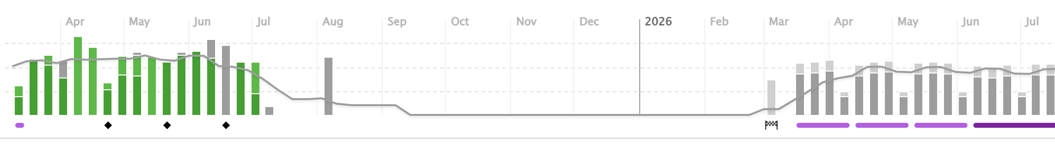

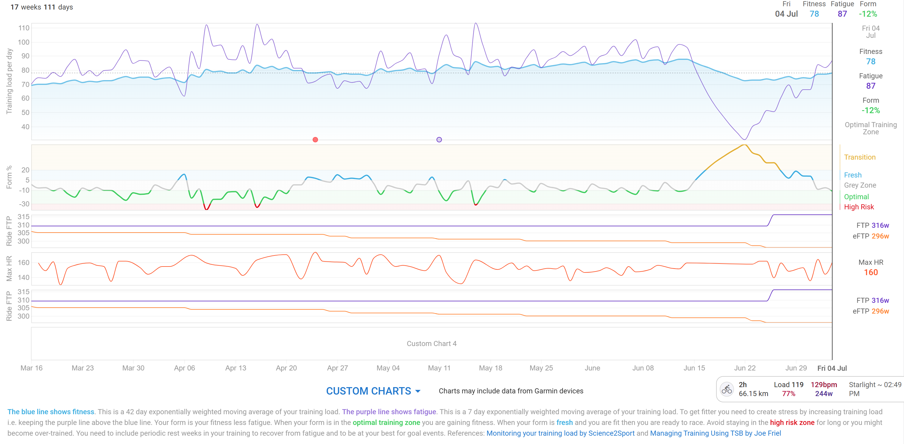

I wanted to circle back on this comment as I think it’s inaccurate to suggest I’d get the same benefit from the current plan builder even if followed to the letter.
See below a comparison of what I’ve done for the last 17 weeks where my TSS has been in the range of 580 - 620. On the RHS of the calendar/plan we can see the proposed equivalent plan builder recommendation resulting in a TSS of 440 - 500. Do note there’s even a whole week of skipped workouts (no doubt included in the most recent stats quoted above).
In terms of receiving a good feedback loop and tracking my efforts it’s been great to have intervals.icu tracking RLGL equivalent and time in the optimal training zone as below. Would be amazing to see these metrics within TrainerRoad.
The last 17 weeks was made up of 58 Indoor TrainerRoad workouts and 22 Outside rides.
