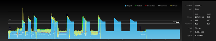

My screen shot showing all the power spikes on the rest intervals. The resistance pulses for some reason.
That power profile does not look good! Have you tried the workout in erg mode?

Figured out what it was, The trainer is paired with BT and ANT+. using the resistance mode button in the workout only toggles 1 ‘device’ so erg and resistance were fighting each other. removing the ant+ pair fixed it.
