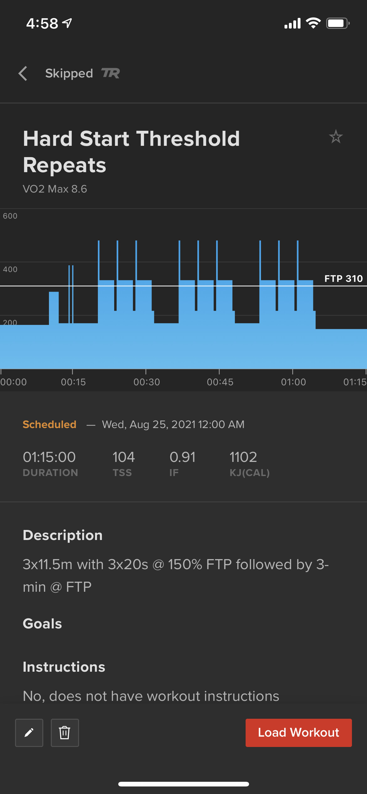

I did create this workout which I’m looking forward to doing…this is to mimic a race scenario where you have to smash up a little climb, hold it for a while, and then coast a downhill. Something I see all the time in cyclocross racing. Very applicable to other forms of racing too I would imagine. Smash > Hold > Settle > Repeat
Overs are 20sec at 150-155% (all out, basically) and the other overs are 3min at 100-105%.

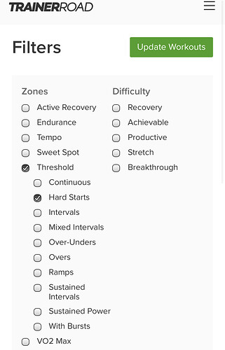

Pretty sure something like that is in the TR library, I saw it in someone’s timeline recently. Also think short power build had somehing like that, with an added sprint at the end of each block.
