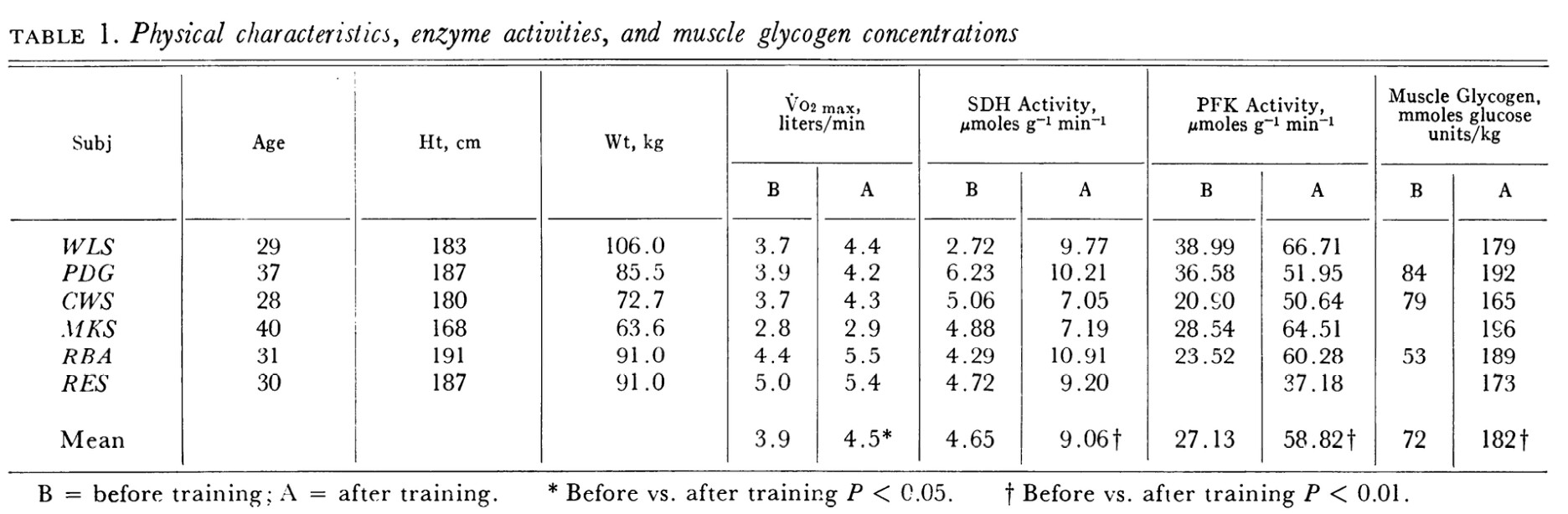

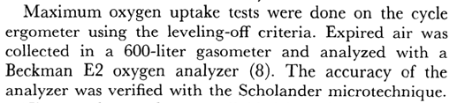

they didn’t estimate MAP with a ramp or anything like that, they tested actual maximum oxygen uptake:

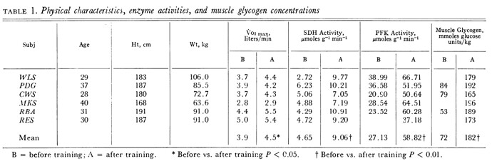

and not surprisingly, vo2max increased for all of them as they were healthy, recreationally active people that had no prior endurance training for the past 2 years:
