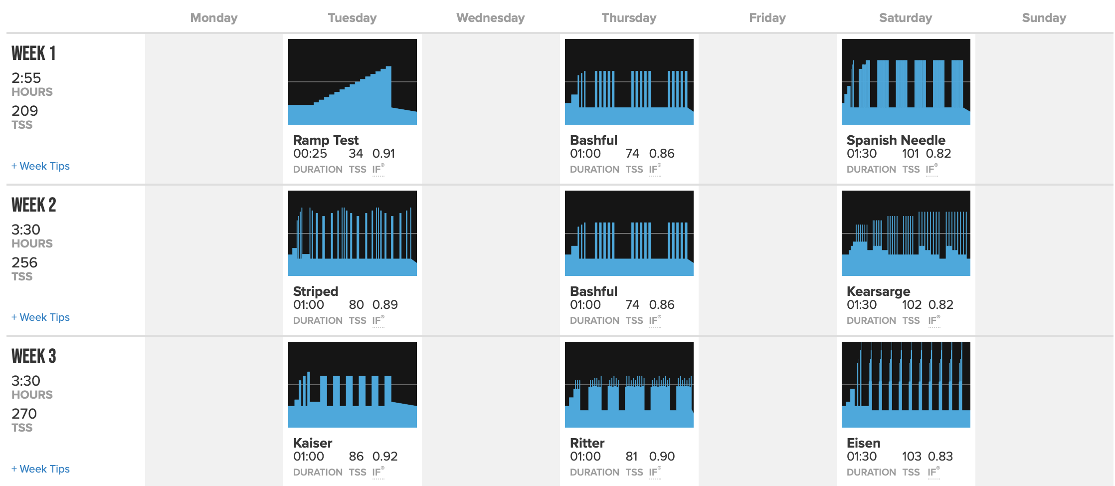

Here is the first couple of weeks in HIT Maintenance Low Volume 1 plan:
My input based on doing spin classes in 2014-2015 is to do Tue/Thur at 45 minutes HIT, and then a longer 2 hour ride on Saturday.
Which isn’t polarized but is what I would do.

one last comment, you might consider:
  • Tue 45-min HIT
  • Thur 45-min tempo or top of z2 with some cadence work
  • Sat 2 hour middle z2
