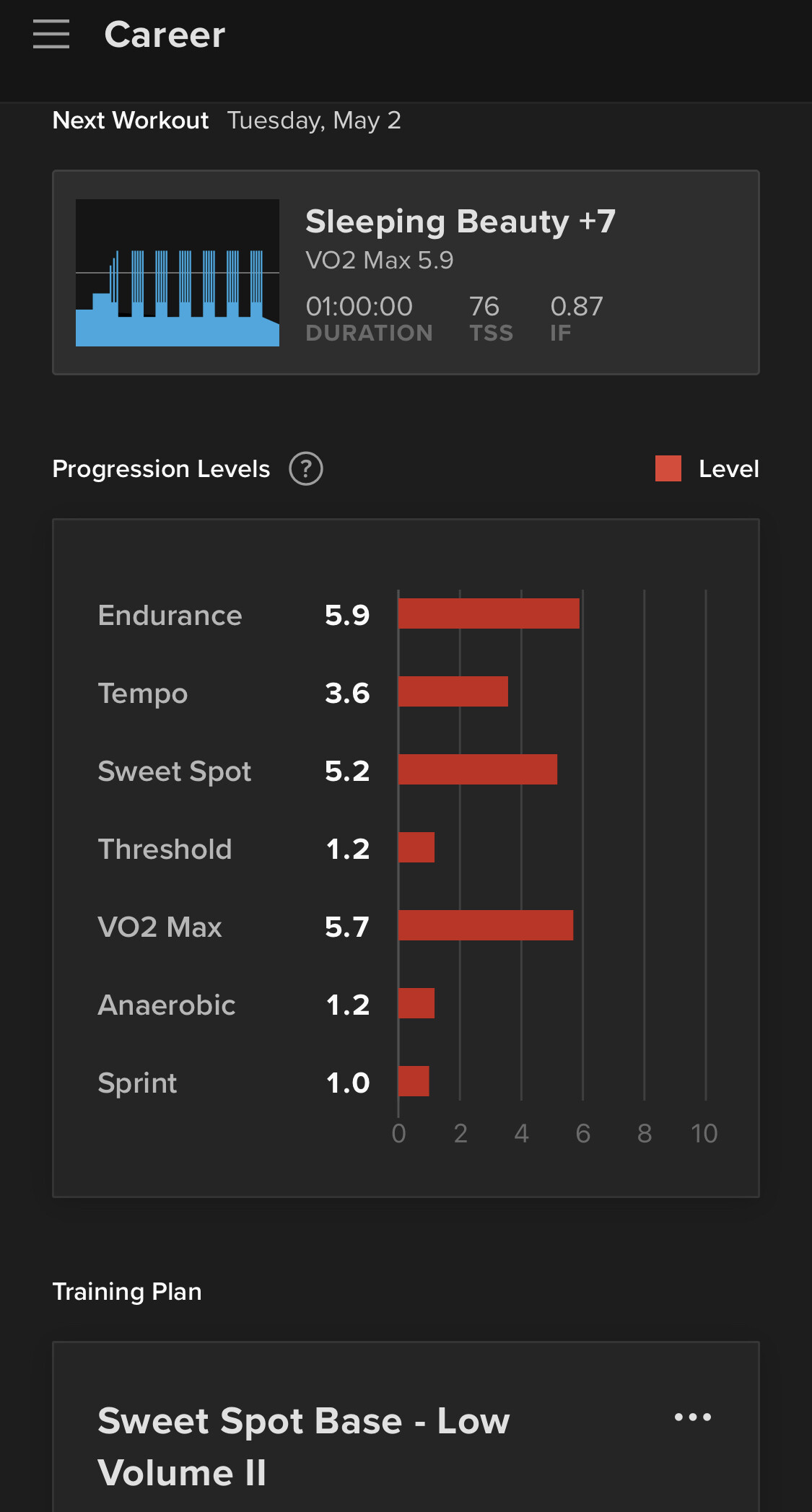

You can do this yourself using Alternates. If you want a harder workout, select a harder one from the alternates - your have options to select time & achievable, productive, etc. to filter the list of workouts like in the screenshot below. This is really the easiest way of changing a specific workout to be harder / easier.
I know but not what I’m getting at. If I select a workout that was too hard but manage to complete it with a few bailouts and absolutely wrecked, my progression level goes up to that respective workout even when a lower one might be more appropriate. Hence reducing that by 0.2 points will be more accurate.
It’s easier to go up than back down because you just select a harder workout but in the case the difference is pretty large, it can help recalibrate a little more quickly. And it’s one less workout to get to the right spot
If you are feeling totally wrecked, are you rating the workout as All Out? If so, and AT is giving you full PL credit, than that feels like an AT bug.
That’s what spurred this request. I just finished junction -5 and I was given full PL credit despite rating it all out and “intensity” for my reason why. This has happened with a few other workouts in the past.
