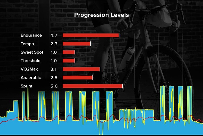

I assume this is the workout you are referring to?
I am not surprised that TR didn’t use that to assign any PL bumps. Going off of what details we can see in the TR screenshot those are more than brief rests and it looks like none of the intervals were completed as assigned.

A pedal break is a few seconds out of a 15+ minute interval to stretch your legs. You spent more than half of the total interval time well below the target power. That’s not even close to the specified training. It’s not a pedal break, it’s you apparently not being able to handle the interval (maybe you can, but in this case you didn’t do it).
IMO it’s totally reasonable for the algorithm to classify it as a failed workout (it was!). Trying to give partial credit when your execution was so far off the mark doesn’t really fit with TR’s approach of gradual progression of workouts. If you follow a TR plan then you would never be at a PL of 3.1 and be given a 10 workout (unless you hit a bug).
You’re right that it was still some VO2max stimulus. Great. Garmin’s (not so precise) algorithm gave you a 1.8% bump in your VO2max estimate. So what? That’s basically a rounding error.
There’s nothing TR needs to change here IMO. You already manually picked a higher PL workout than TR recommends. You can do so again if you really believe that you can properly execute and would be better served by a higher PL workout.
But don’t let your ego bite off more than it can chew. Start with something like (your current PL + 1.5) as the workout level. Execute it with near perfection. Then evaluate if you can and should go higher again. So you should try a PL 4.5 workout and do it without any “pedal breaks”. VO2max intervals are short enough that you shouldn’t need any.

You didn’t complete a single interval. Getting to the end of it doesn’t mean you did it.
What is your max HR? For this effort it was 181 so I’m guessing it’s higher than that. Your average HR for the VO2 intervals were:
152
150
161
157
146
149
So of the 6 intervals of 3 min Vo2max you spent zero of them at 90% or above HR (based on 181 max…which I’m sure you max is higher which makes your intervals even worse for making it into actual VO2max).
You spent less than 12 minutes TIZ for VO2max when the workout called for 19.
So if this were a test you failed every section. Why do you think you deserve credit for it?

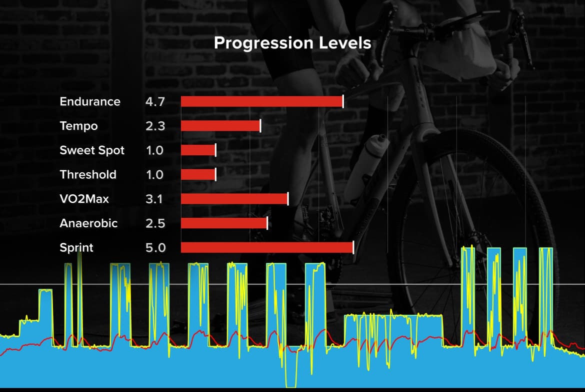

Essentially what you are asking for is for TR to rate the workout based on the work performed (ie - what you did), not the work prescribed (which you didn’t do). That is the feature many of us have been waiting years for.
With the way you executed that workout, you are also highlighting the difficulty of developing the ability to rate “unstructured” work. Looking at that power/HR graph, it would be really hard to guess at what (if any) quality adaptations are happening. Good luck trying to compare that to previous efforts to determine progression or not, I personally wouldn’t know where to start. A key part of determining progression is to do things in a somewhat repeatable and measurable way. X power for Y minutes with Z rest between intervals is the typical formula. Are there adaptations happening when you don’t follow a structured formula? Most likely, but good luck finding a meaningful correlation. There is a reason athletes train with structure using powermeters and stopwatches, it’s proven to be sucessfull. Will there be a day that a really intelligent system can look at a “messy” workout and make sense of it? Probably, but I’d still bet that using a messy approach won’t be as effective as following prescribed workouts.
