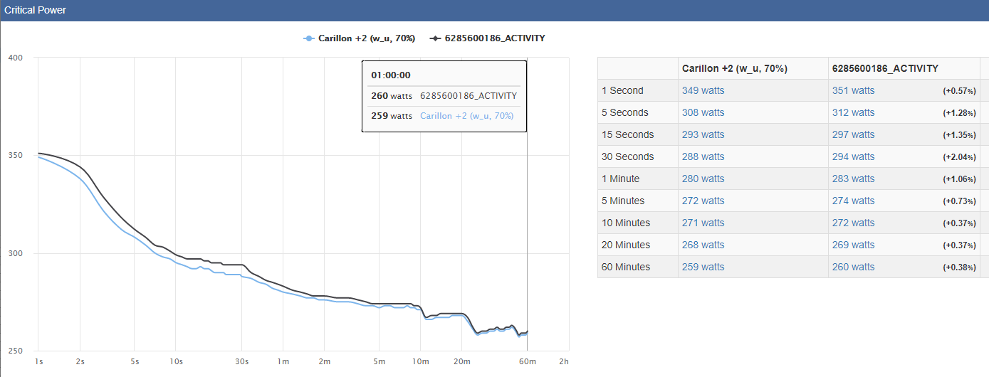

FWIW, I updated the firmware a couple of days ago and the pedals have worked just as well as before. They continue to track within 1-2% of my trainer. Just the way I dismount my bike my pedals naturally end up vertical. The bike is left on the trainer (vertical) and I’m not a triathlete so I take my shoes with me. Auto calibration seems to be working well.

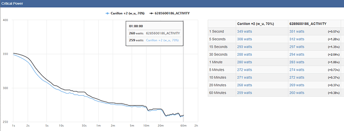

Which program / website did you use for that comparison? Looks good.
ZwiftPower.com (Profile | Analysis). You have to subscribe to Zwift, though. DCAnalyzer also does similar analyses, but you also have to pay for that, too. I’m not aware of any free sites that do it. You can probably do something similar in a spreadsheet if you import the FIT files, but it will take a little bit of work the first time.
Cheers. I’ve used Rainmaker’s tool a few times in the past. I like the clean, easy to see at a glance appearance of that Zwift tool though. Unfortunately, I haven’t got a Zwift subscription.
Golden Cheetah has a compare function that’s not limited to the PDC and free.
