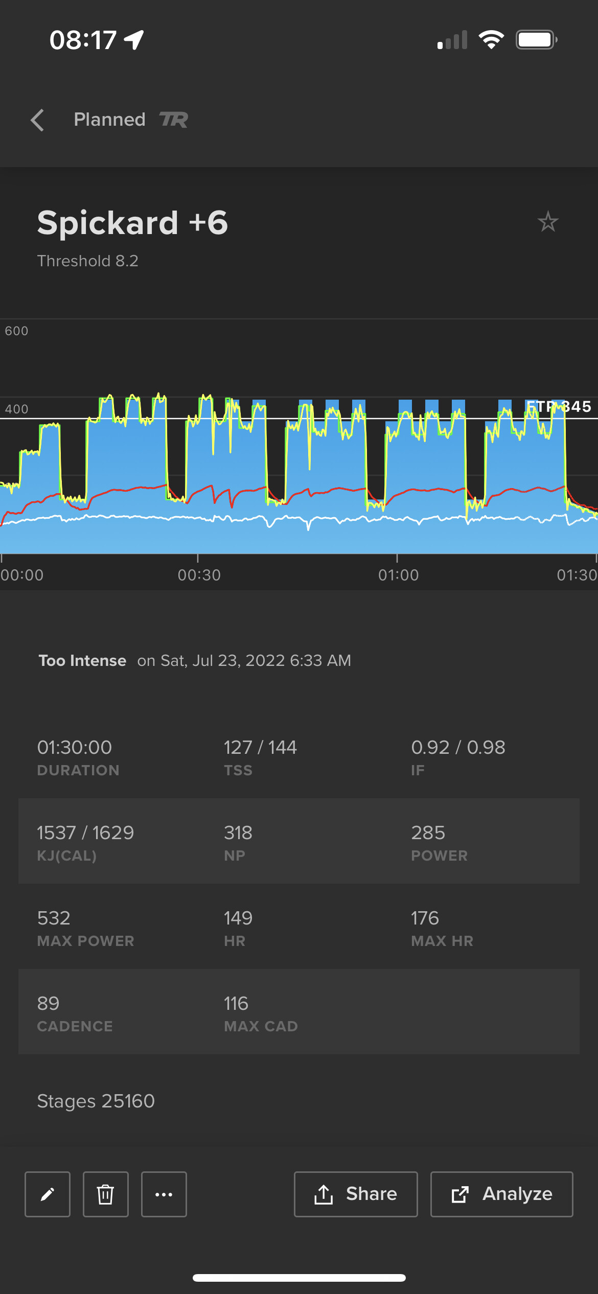

I am finding I can nail threshold workouts in the 7.X range but everything above 8.X kills me. I have failed TR workouts twice — and both were Spickard +6.
I wanted to beat this workout badly. Unfortunately I didn’t have it in me… cracked on the 2nd set and struggled to come back, finally settling on 90% to finish out the most challenging and ugly workout in months.

I think one of the risks with threshold workouts like Spickard+6 that go way above FTP (115%) is related to ERG mode and smoothing. It’s really easy to get into the death spiral when you’re that high above FTP even if it’s only for a short time.
Looking at the ride analysis, a significant amount of time was spent overshooting even beyond the prescribed 115%FTP (397W). (I attempted 4x2min intervals at 115%FTP so total 8min)
More power is the solution. Or maybe I was just not being as smooth as I should have been. :slight_smile:
Even if you weren’t overshooting - 115% for over unders where the “under” is at 98% (read: THRESHOLD) is crazy town. The O/U is supposed to “shuttle” lactate - or let you use the lactate as an energy source below threshold, but this is just let’s just flood your legs with lactate above a sustainable level…and keep it there.
I would love to see one of these rides completed and compare it to the athletes other rides - to make sure their FTP is set appropriately (or guess we just need their RPE for the ride…).
Good for you for trying this though, Anything above a 5.0 for threshold is the real deal
Strange workout, given its goals. I think of offered it again I’d swap it out for a different workout with similar PL, but longer intervals at lower intensity.
Maybe the reasoning is that if your FTP has risen over the course of the block then that 98/115 is really more like a 90/105. Though that’s be an 8% FTP increase, I’m not sure many would be achieving those gains.

Spickard +6 is 90 minutes at an IF of .98. That is huge.
.98 IF for 90 minutes kind of implies a 90 minute TTE at FTP. Which probably means that your FTP is sweet spot and not FTP and needs to be changed.
So a workout like this is sort of nonsensical. And should never work with a correctly set FTP
