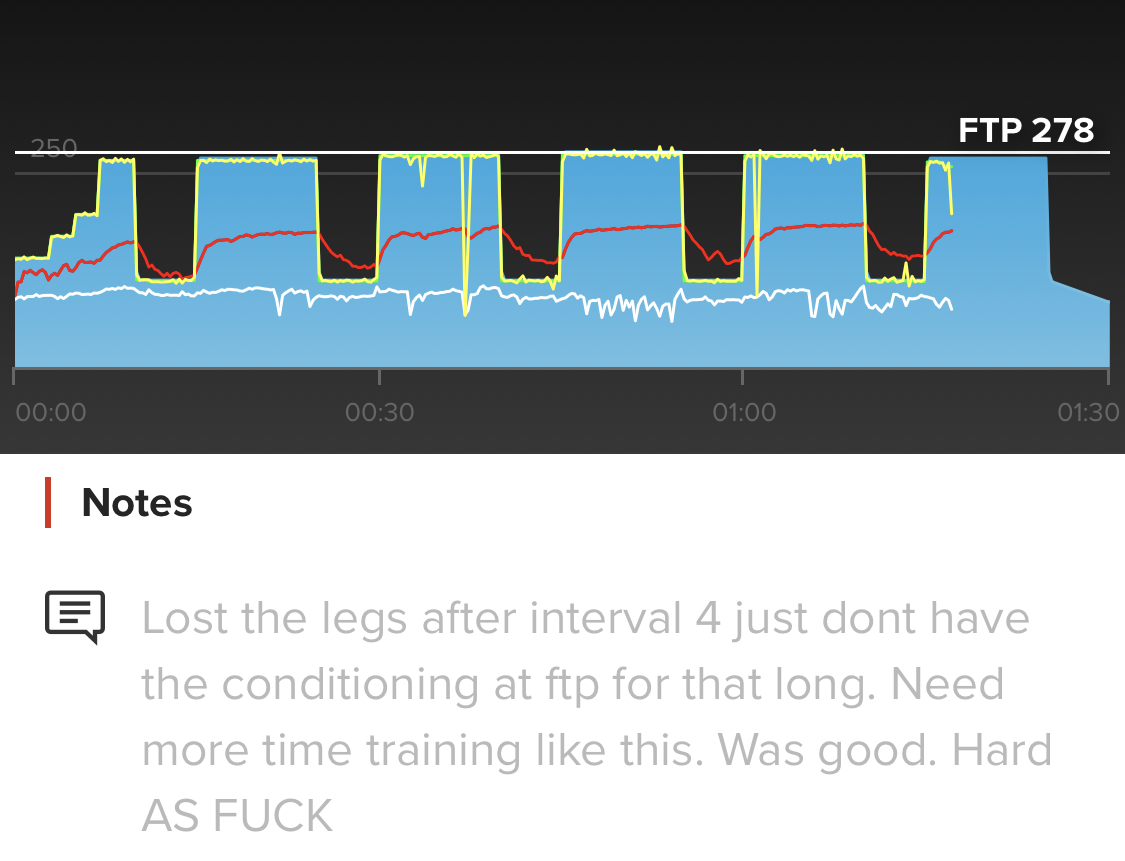

“just started TR”.
Doesn’t this jive well with the other thread of SS Progression?
There’s a whole thread with people just talking about building SS90% from 2x15 minutes up to 1hr+.
Would it not then make sense that the same applies to the TR plans? I.e. you have to train a while to do 5x10min at this intensity?
Seems to me people are struggling with knocking out long SS/Threshold at the beginning of a block no matter who’s ideology they are following.
And I bet some of is because of being stuck inside on a trainer. Doing well in such a mundane setting isn’t for everyone.

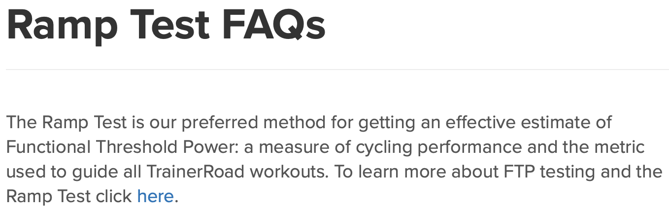

As you said, the ramp has been sold on the podcast as a tool to increase compliance. The TR FAQ takes a different tact:
See why we are debating? TR’s official position is:
  • ramp test gives an effective estimate of FTP
  • FTP is a measure of performance
  • FTP is used to guide TR workouts
My favorite part of the FAQ is where TR marketing department points out a good ramp test is better than a bad 8- or 20-minute test.
